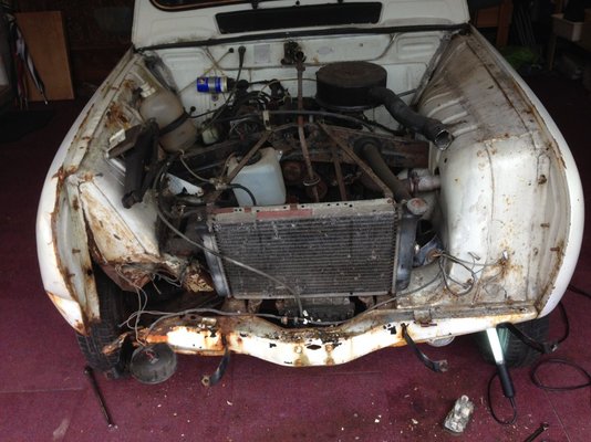

The bonnet more or less fell off.

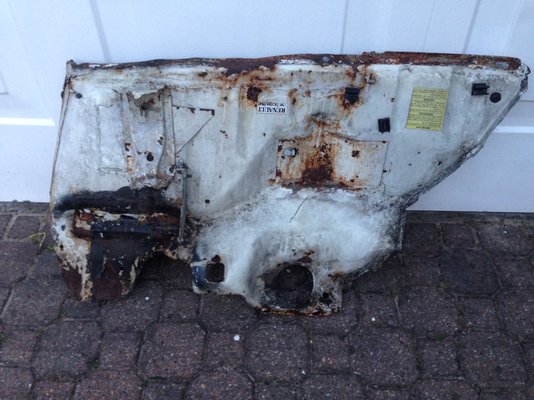

Getting the right hand side wing off was fairly easy.

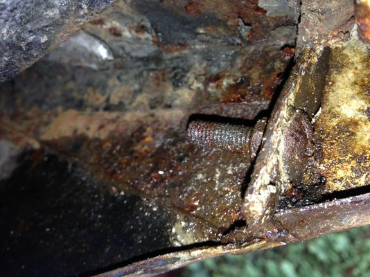

Initially I thought I'd leave the left wing as it is solid and the inner wing has been patched, but now I've decided to remove that side as well.
However, I am currently stuck as I cannot undo the bottom nut and bolt that holds it to the triangular panel behind the wing and I cannot get my angle grinder to it.

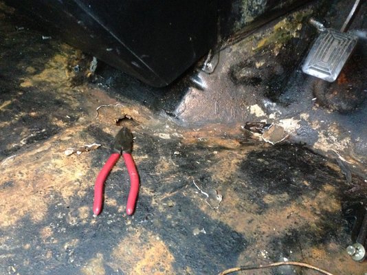

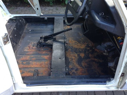

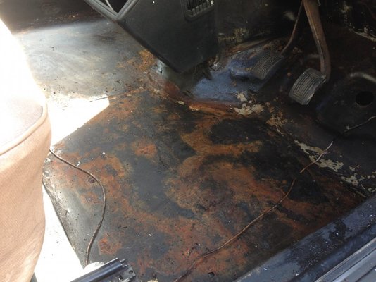

When I removed the rubber floor mats, it was not a pretty sight.

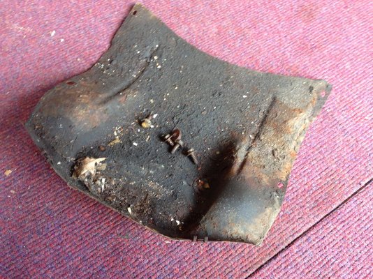

I guess this was once soundproofing.

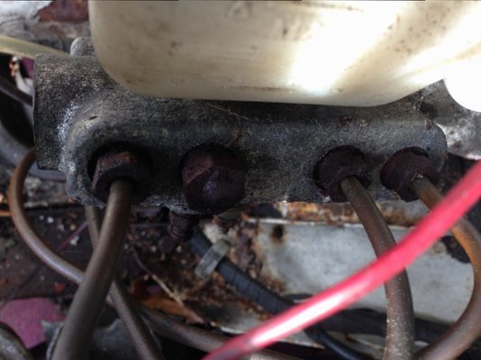

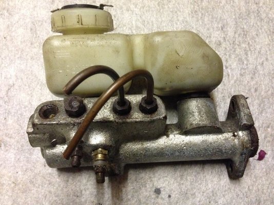

To remove the right inner wing I needed to deal with the brake lines which passed through a hole in it.
However, I was unable to undo them at the master cylinder so ended up cutting them. Note there are only three lines.
As you can see I was able to undo one of the lines.
The inner wing then came off easily.

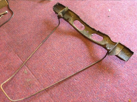

Before using the angle grinder on the other wing, which was not accident damaged and is very firmly attached to the car, I wanted to remove the danger of fire by removing the petrol.
I could not remove the air filter cover to get to the carb and in the end removed the carb itself. I made a video in case other people feel a fool like myself for not being able to get it off. Knowing how it sits on the filter holder helps.
I could not drain the fuel tank because the drain plug was seized so decided to remove the tank.
This proved time consuming because I did not realise until I asked a question on this forum that I had to remove the cross member behind it. I knew about a cross member but thought it supported the tank (ie was under it) and that it was missing from my car.
I also spent a while trying to undo the spare wheel carrier not realising that it would come away anyway with the cross member. Seems obvious now but at the time I did not recognise the thing as the cross member.

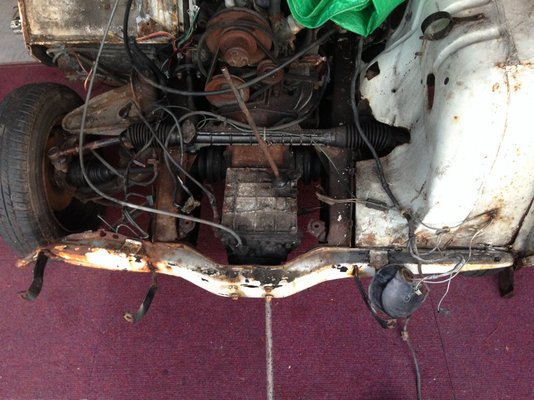

Lots of other bits and pieces have come off in the last week, normally to facilitate the removal of something else.
It was pleasing to see that the right front chassis rail appears to be straight.

Oh and for seized bolts like the one pictured above I bought a Sonic crafter from Homebase when they were on offer, they are a vibrating saw, and you can get bi metal blades to cut soft metal with.
They are neat, and far easier to use than an angle grinder in tight spaces.

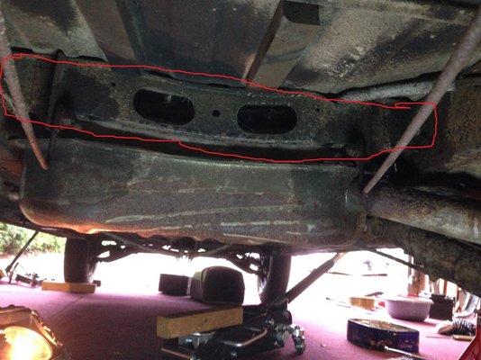

I realise something...
1. This is not a Renault floor.
2. There's a hole
3. The two bolts that would have held a Renault floor to the chassis are nowhere to be seen.
Oh, and in the back, the bolt that should hold the body to the chassis ahead of the nearside wheel arch is not there.
I need to get underneath and poke about, but not tonight.
