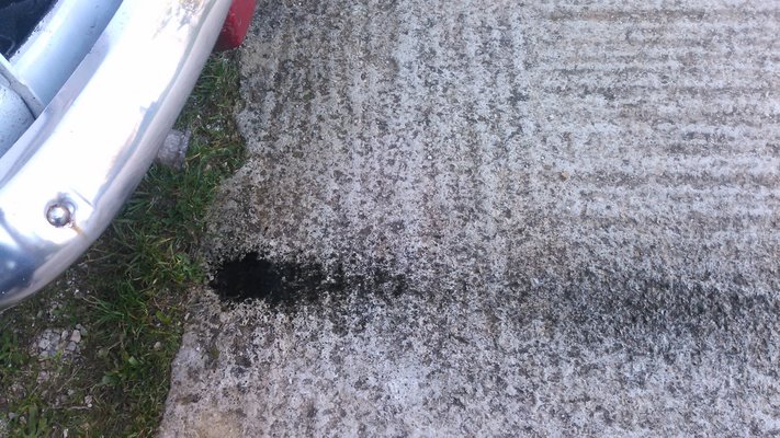

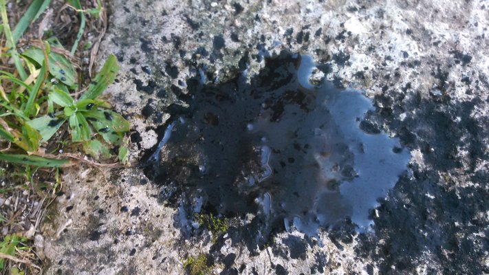

    So, cleaned the carb thoroughly and and now it runs better than when the mechanic supposedly adjusted and fine tuned it. I just adjusted the little screw by feeling and went for a test drive. Now it even drives with the choke fully closed, but it does not accept a full throttle and chokes if i don't apply the throttle slowly.
    Also, i noticed this after cleaning the carb. It's 2 minutes worth of idling and some revving.

    Before you carry on, have a look at your spark plugs. They probably look like that stuff on the floor and will need a clean.
