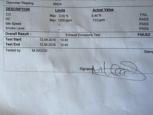

OK so Ive got 20 hours berfore Ruth (1990 Renault Campus 1.1) has to got back into get retested.
Done So Far: 1. Changed air filtwer
2. Changed plugs
3. Redex fule additive
Ive adjusted the idle to a bit higher
Found the Mixture screw:
Clockwise all the way in to make the mixture leaner .....good for passing emmissions right?
any help advice muc appreciated chaps.

Hi Reidy et al
Renault 5 Campus 1990
Here is my original 'fail' MOT with emissions readings.
Bear in Mind the emissions limit for my car is 3.5%

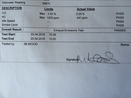

I didnt have time to get your tri-pak as I only had 24 hours.
This is what I did:
Changed air fliter
Changed spark plugs
Added Redex fuel additive
Turned up the idle speed
Turned down the fule mixture screw practically all the way (clockwise) to make the mixture leaner.
Engine was just going
Turned the screw anti-clockwise just a little so the engine was just going
Took the car out on teh Motor way for 25 minutes and went as fast as possible
Went to the MOT.
Heres my result
