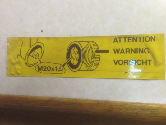

Arriving back with the spares, it's under the hot engine on the hottest day of the year to undo the squareheaded drain plug (10mm open ended spanner). Not a lot of oil came out. Doh! This is the transmission oil! Never mind it's a bit dirty so I've changed it anyway. Then the engine drain plug (13mm spanner). Hmm, the engine oil is filthy, a bit sad especially after 2,808 miles. Off with the oil filter and what a b****ard of a job it is to gain access to it. I have a special tool which consists of a spring steel hoop and a threaded rod. Tighten up the knurled knob on the end tightens the spring steel which grips around the outside of the oil filter. Well it should do except the hoop was too long so required shortening and a new hole drilled into it for the grub screw. Once done, the access around it is so restricted, that it had to be undone a little at a time before finishing off by hand. New filter, oil the rubber seal, clean around the seating on the side of the engine and fit back on. Hand tight is sufficient.
