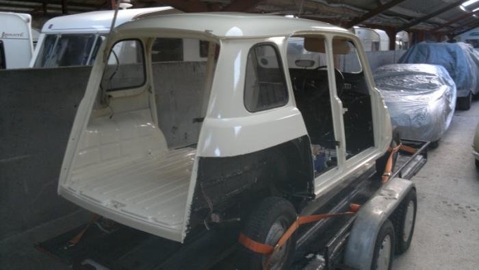

Well perhaps not quite yet, but we have had a fairly mild few days up here, and so, I have made bold with the paint once more, and as you can see, have now painted the main shell.
The roof still needs another coat and I will probably apply another to A panels and rear quarters. The inside is good enough given that most of it is covered up with rubber mats, etc.
If I can get another coat on that roof this next week, I have next weekend largely by myself, and so will attempt a start on some reassembly.
Tatty edge around the windscreen is J tape. You only need minimal masking when rollering a car.

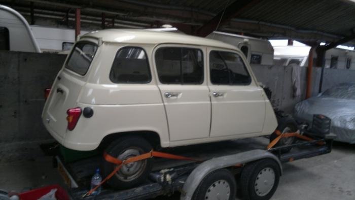

Managed to fit both rear wings this weekend. Quite surprising how much fettling is required, even to fit the original panel back where it came from! However, everything seems to have come together reasonably well.
I then hung the doors and tailgate. The rear nearside door binds a little on its lower rear corner , and obviously needs a tap on the hinges to adjust. Fortunately the Renault 10mm panel gaps all facilitate some adjustment. I'll take my large mallet next visit!
Finally, scrubbed down all of the rubber mats, which have come up really well.

Beautiful !!!
And you did the paint job using the brush not spraying? Incredible!
Keep the pics coming ...
David
Yes, it was all done by foam gloss roller, with just a few odd detail areas done by brush, as per my 'Paint your wagon' thread in the technical section.
The finish straight from the roller is quite good, but once I have reassembled everything and then touched up any minor scars that result, I will flat back any blemishes and compound it all and bring up the shine properly.

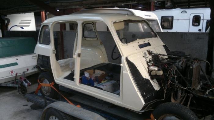

Managed to get a few more hours in. Adjusted the sticky rear door (ahem), fitted the rear bumper, nearly lost my fingers retensioning the tailgate stay.
Removed the manky front bumper brackets too, which took quite a while, with the help of a blowtorch and a lot of swearing.
Finally, I gave the front end of the chassis and the battery tray, a coat of paint.

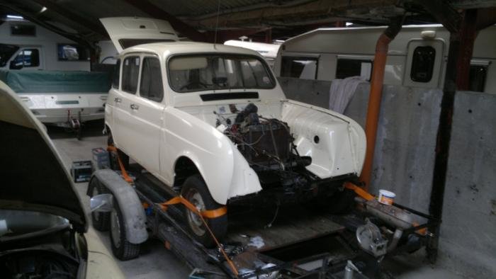

Slow progress recently due to a bad back. Nothing too disastrous, but enough to tell you when its had enough and when to call it a day.
In spite of this, I have managed to clean up and scrub the seats, which have come up extremely well, and then to weld the broken hinge bracket back onto the back seat again.
On the car itself, I spent some time fitting the front end back on again. As with the rears, there was a certain amount of fettling required and the whole lot came off a couple of times to have some judicious bending and twisting carried out. At the moment I have left everything just bolted together, with no attempt at sealing or bedding joints as yet, and some final fixings not finished along the A panel joint, since I came to the conclusion that I needed the bonnet lid to make sure that everything would fit together properly and that it was a waste of time going further without it.
Unfortuinately the bonnet lid was several miles away and will require the roofrack to bring it across, since it is too big to fit into the rear of my estate.
So, we're getting there, it still looks a bit wonky in the metal, but the next visit will hopefully see it fully adjusted and sealed (back permitting).

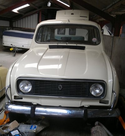

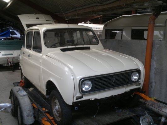

Managed to get the bonnet across yesterday and test fitted. I used the roof rack, as per my previous post on the subject....reluctantly. I have seen too many lost loads from racks over the years to feel really comfortable with one, but this went uneventfully apart from a rather alarming resonance above 30mph and I drove very sedately, with pictures in my mind's eye of a vibrating lashing strap wearing the paint away somewhere.
Anyway, the bonnet went on okay and after a little pushing and shoving the wings line up reasonably well. The hinges require a little packing to get a better alignment between bonnet top and wing upper edge, but other than that, it looks as least as good in alignment terms as the original car, before dismantling.

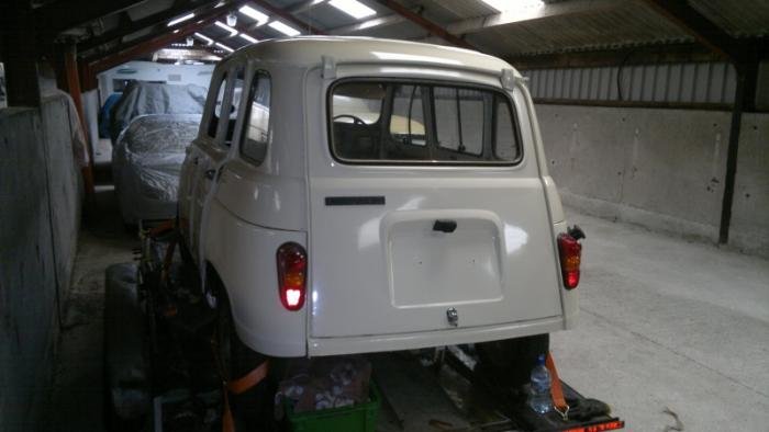

Still suffering slightly from backache here and there, but in spite of that I have made good progress over the last couple of visits. Its amazing how long it has taken me to get the front end reasonably straight and true, and it is still not absolutely perfect, but looking through the galleries, it is probably representative of most of the good daily drivers, which is what its destiny is and I am happy with it.
Finishing touches this morning after a good final tightening up of all the panel fixing bolts and screws were nudge bars (or love handles?) and front bumper.
Anyway, the external body is now all but complete, with only rear door rubbers to fit , chrome trim strips and some adjustments to door latches, which I may leave until the very end, at which point I will also touch in a few bits of paintwork that have suffered en route.
Inside I have fitted the rear seat, parcel shelf and rear quarter trims, which I have also re-covered in vinyl.
I will aim to finish off the insides in the next visit, by fitting seats, belts and mats....and then its on to the machinery what makes it go (and stop).
