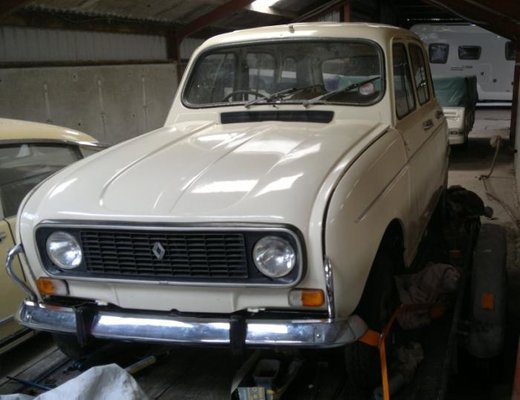

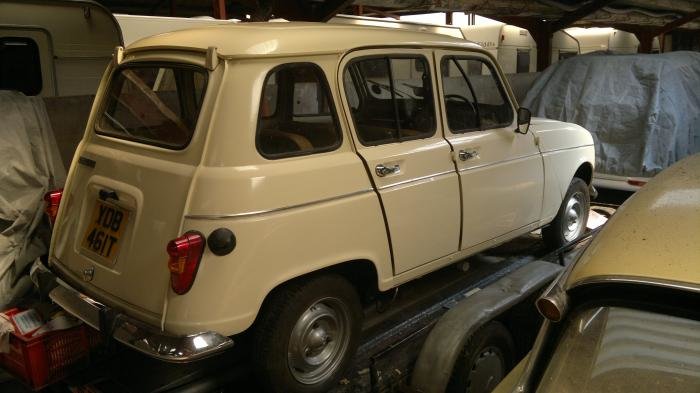

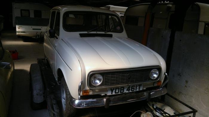

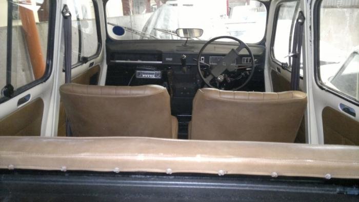

A few more recent pictures to be going on with.
It looks a bit odd working on atrailer, but in fact, for me, it puts the car at exactly the right height for many of the areas that I am working upon, and removes the need for ramps, jacking etc. for a lot of the time. Plus the lashing on the nsf wheel was a useful way of stopping it moving when I was freeing up the engine the other day (handbrake is still on the front wheels, on this model).

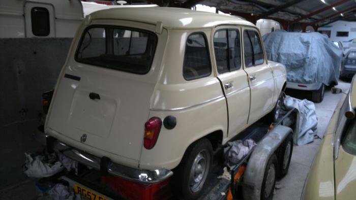

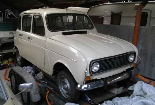

A couple more pictures, we're still parked on the trailer (makes getting underneath for the brakelines much less back aching). Most of the plumbing is complete now, just a couple of joints and a bleed and hopefully, we'll have brakes again.
I have ordered rear hatch seals and some flexible brake hose clips from Franzose, and sundry minor items from Ebay. The end of the tunnel is hopefully in sight.
