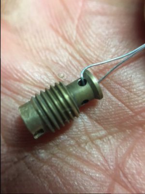

    Of course it might be possible that someone has changed your main jet to a bigger size and that's why you're using more petrol. Your main jet should have 91A printed on it. You don't have to dismantle the whole carb to check this. Have a look at my post.
    In 2010 Angel also suggested using thin copper wire as in my picture below to reduce the amount of petrol in the main jet. Never tried it myself though.

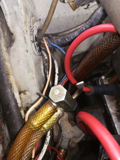

    Finally, after lots of frustration, I decided to try the return pipe suggestion. Put a 't' splitter immediately after the fuel pump, one outlet heading back to the tank and other to the carb. This fix allowed me to do an astonishing 47mpg. I have no idea why this would work, because I used to imagine that the float tap in the carb, would not allow more fuel once the chamber was full. The car drives smoothly, and the smell of unburnt fuel that was creeping into the cabin has vanished. I will take a few photos of the car tomorrow as well and share with all. Good evening and good night, from Nairobi, Kenya.

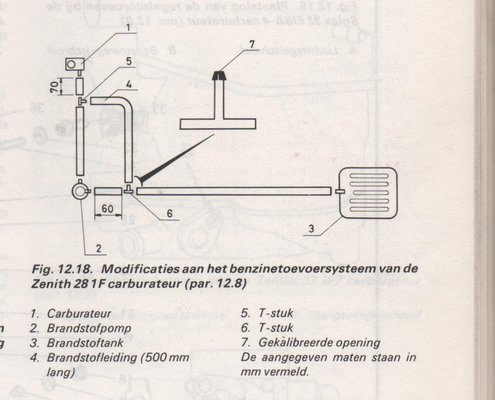

    According to the book of Haynes, chapter 12, section 8 describes a return line only according to Zenith 28if (or 281f?) carbs.
    I'm considering going for this option with a fuelpump with calibrated return.
    See enclosed picture and sorry for the Dutch descriptions I haven't an English Haynes book...

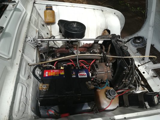

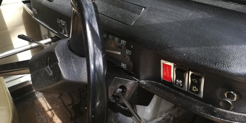

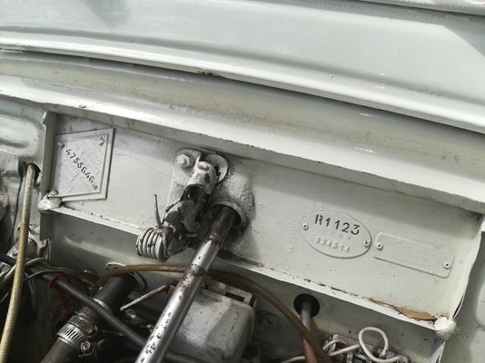

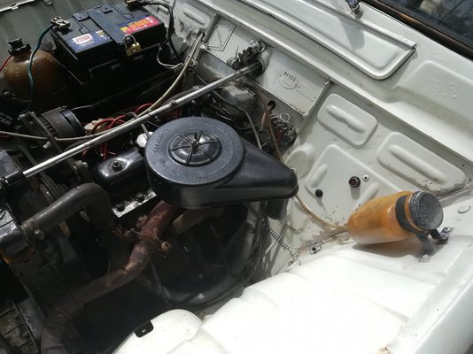

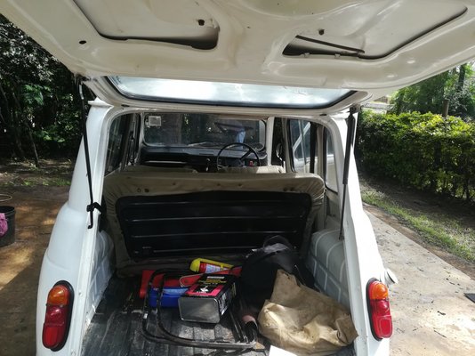

  16. Brian Moseti Enthusiast
    Messages:
    34
    Location:
    Kenya

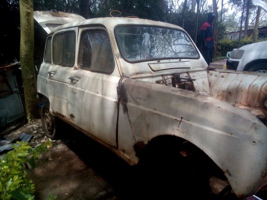

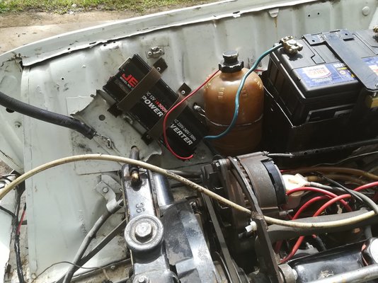

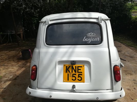

    Thanks everyone..see the image below showing how I fixed the return pipe... also attached are photos of my car...including the restoration process IMG_20180421_101940.jpg IMG_20180421_101940.jpg IMG_20180421_101912.jpg IMG_20180421_101940.jpg IMG_20180421_101940.jpg IMG_20180421_101912.jpg IMG_20180421_101940.jpg IMG_20180421_101940.jpg IMG_20180421_101912.jpg IMG_20180421_101940.jpg IMG_20180421_102009.jpg IMG_20180421_102043.jpg IMG_20180421_102035.jpg

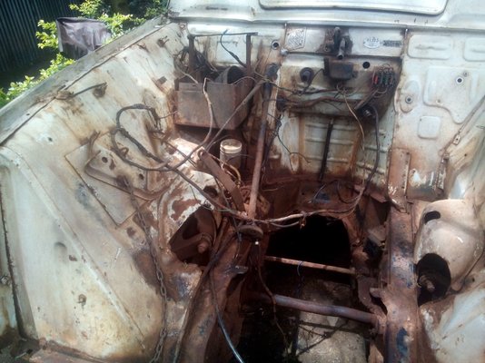

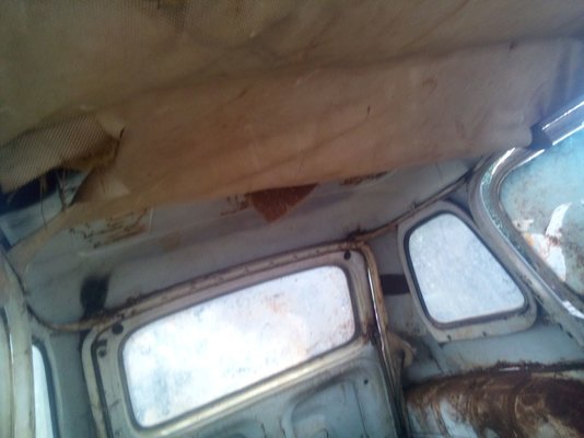

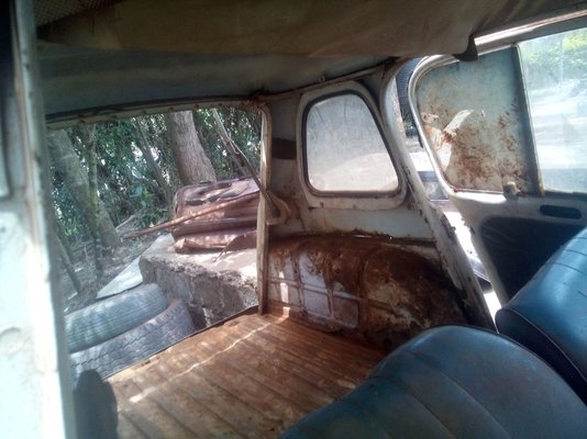

  17. Brian Moseti Enthusiast
    Messages:
    34
    Location:
    Kenya

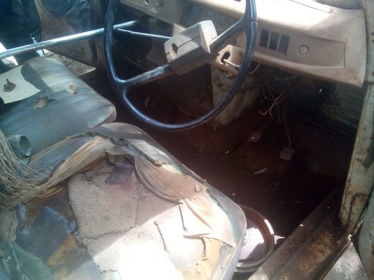

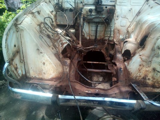

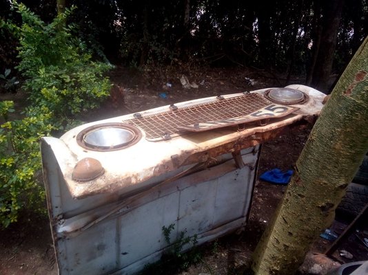

    Here is how the restoration happened

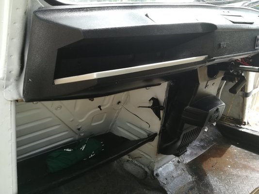

  18. Brian Moseti Enthusiast
    Messages:
    34
    Location:
    Kenya

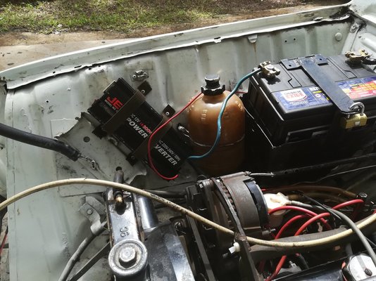

    IMG_20180421_102119.jpg IMG_20180421_102125.jpg IMG_20180421_102327.jpg IMG_20180421_102918.jpg IMG_20180421_102951.jpg IMG_20180421_103731.jpg some more photos

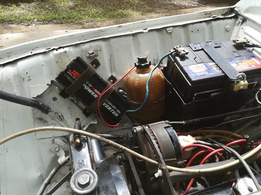

  19. seedc
    seedc Enthusiast
    Messages:
    23
    Location:
    spain CLM
    JdeW likes this.
  20. Brian Moseti Enthusiast
    Messages:
    34
    Location:
    Kenya
    Thanks Seedc... the inverter helps a lot. With the numerous power blackouts around here, I am always guaranteed of somewhere to charge my laptop.
