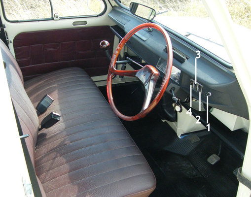

Might you have a wiring diagram for the '81 R4... ordered the Haynes Manual but it wont be here until two weeks. Also, if you can help me find the function of the switches in the image below, I will be truly grateful. My dash came without the switches, but I am planning on fitting them the way they should be originally. Thanks in advance

Sorry for not replying, Brian. My car doesn't have switches like that. I think someone else has replied in your other thread. I only have the wiring diagrams in the Haynes manual, which you hopefully will have soon.
1. windscreen washer hand pump
2. windscreen wipers
3. heater blower motor
4. hazard lights / parking lights / brake fluid level warning, depending of model year.
Is this actually your R4? Very nice interior indeed!
