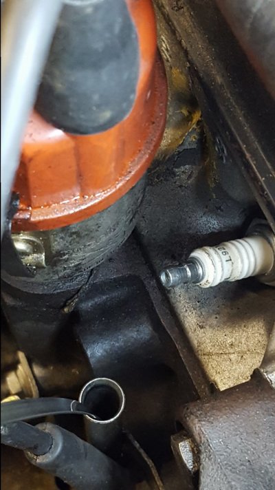

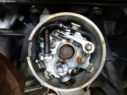

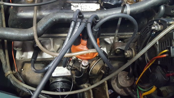

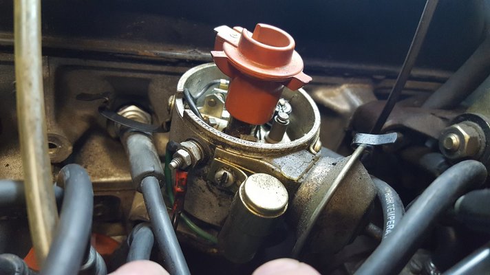

Howdy All
I am about to tackle the next steps on the engine, could you help me identify what distributor I have, I think from the picture I have managed to capture it's a ducellier distributor (I think). Its on my 956cc 1989 R4 and I am looking to replace the points, rotar, cap, condenser, coil and leads as they all look a little elderly and that it's running a little rough. I have considered electronic ignition and again if you can point me in the right direction of the bits I might need. I shall attempt to get them locally and save money getting them shipped from Franzose.
I have tested the vacum advance an that seems to be working ok.
Cheers
Richard.

There should be some information stamped on to the side of the distributor body. That will help with your identification.
I might have to take it out to find out what type I have, or disturb the timing and spin it around..
Richard

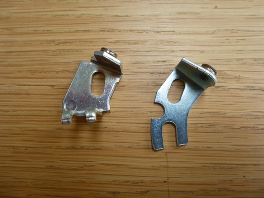

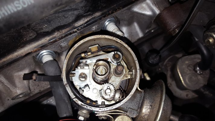

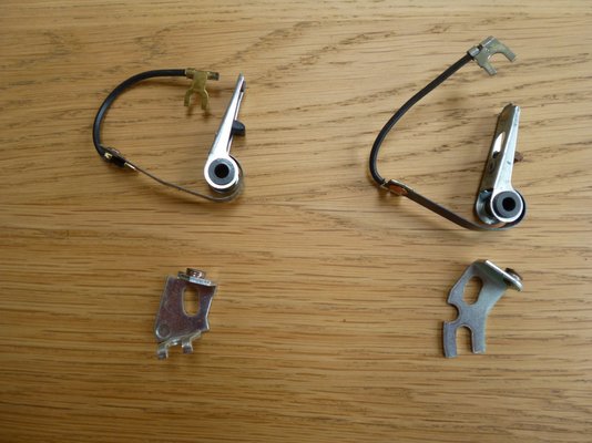

Yes, it's a Ducellier. According to my 'Revue Technique', the 956 distributor should have R268 C52 stamped on the side.

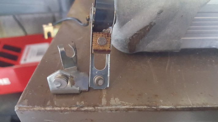

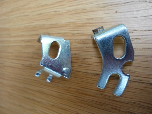

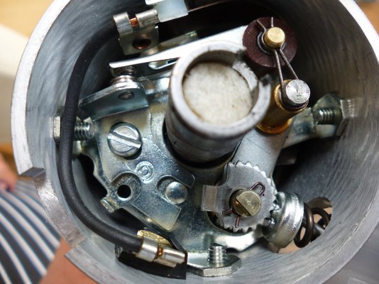

It's difficult to be sure from your photos, but it looks as though whoever last changed the points adapted the 'wrong' set. If your points can't be adjusted from outside the distributor, then you need the set on the right in the first picture- Intermotor 22900 or its equivalent. The set on the left with the backward-facing lugs is for Ducelliers with externally-adjustable points - like the one in the bottom picture. Its fixed part has a protruding boss on the underside which would normally prevent it sitting flush on your baseplate, hence the ingenious adaptation! None of this really matters if your distributor is working well, but getting the 'right' points would save you extra work!

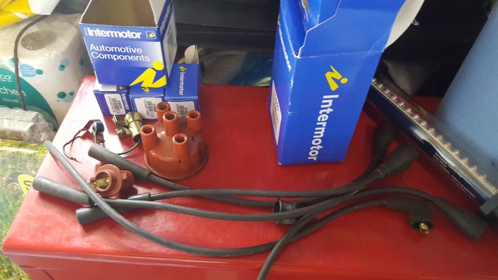

Intermotor references for the other parts: Coil- 11040; Condenser- 33650; Cap- 46050; Rotor- 47400
Thanks Andy - I think you might have nailed the issue on the head, it doesn't surprise me if they are in fact the wrong ones in there.. I shall take a photo in a mo with out the rotor arm in place. Things seem to be working apart from bad timing and lots of pinking under high load / full throttle leading me to think there is an issues with the ignition system.
Excellent managed to order all the Intermotor bits up from my local motor factors to arrive tomorrow including new leads for £66 inc the vat.. excellent :-)
