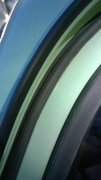

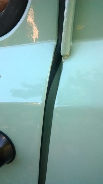

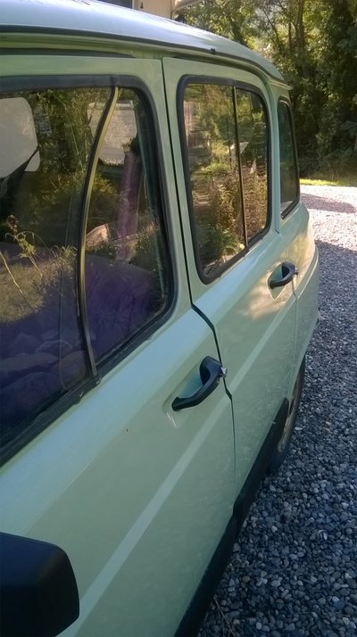

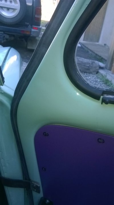

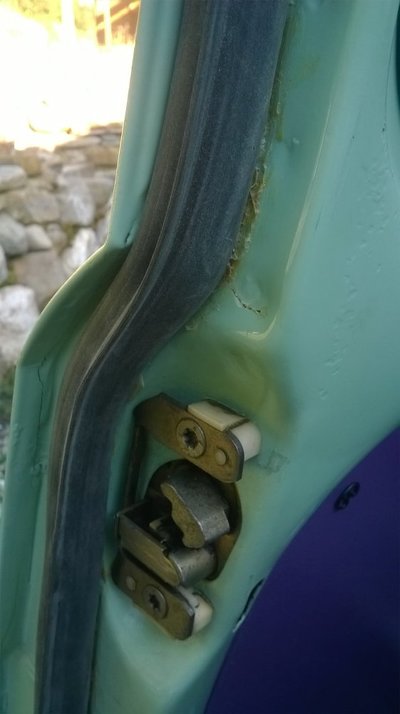

Well, I am pleased to report that the glue did mostly end up on Minty! Definitely a four handed job, but got there in the end. Der Franzose,kindly sent door seals that were more than long enough to do the job, needing to be trimmed of excess. Better too long than too short;) I have fitted new door seals to all four doors and they now close really nicely, just waiting for the glue to go off before I try opening them. Fingers crossed that it has worked this time. Looks promising. I still have the boot to do, but I can only take so many fumes in one day, boy that glue smells! When I get the doors open, I will post some photos. A BIG THANK YOU to all that helped, appreciated.
:clapping:It worked! Love the sound the doors make when you close them now, luxury, no drafts!WP_20160919_15_55_24_Pro.jpg WP_20160919_15_56_14_Pro.jpg WP_20160920_09_36_11_Pro.jpg WP_20160920_09_36_53_Pro.jpg WP_20160920_09_37_23_Pro.jpg Flush fitting, no bulging hinges, result!
