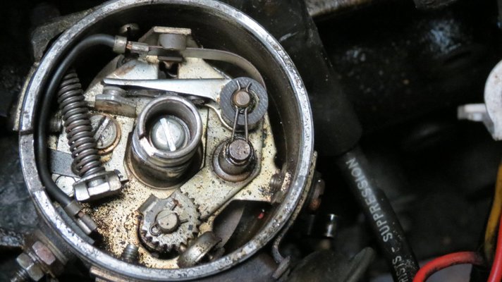

Can anyone advise me on the type/model of electronic ignition I need to fit this type of distributor ? 1985 850cc F4 (French Market Model). IMG_4572.JPG
Can anyone advise me on the type/model of electronic ignition I need to fit this type of distributor ? 1985 850cc F4 (French Market Model). View attachment 18112
Best but expensive is 123 ignition which replaces the whole distributor I have not had much success with kits but there may be one available.
In the past we have sent the small distributor to a specialist but it would not take the kit.
Hi Jeepman, try Aldon Automotive 01384 572553, they do an electronic ignition conversion for the Ducellior distributors. I have one fitted to the dizzy on my GTL. Your dizzy is probably stamped D287 D83, and of you quote that number they may be able to help you. Their system is all contained inside the distributor, with just two small cables going to the coil. The one I bought for mine cost just shy of £150, part number EP141 for curve D244 D61. Of course they may not do one for your dizzy, but it's worth asking.

After chatting to Brian (Cornish4) and Vincent Modica at yesterday's Kent Meeting, I have ordered an Aldon EP141 electronic ignition conversion (about £141 incl. postage and VAT). It is apparently dead easy to fit (although I've heard that before) but a 123 unit transformed my Citroen 2CV6 making it start first time, improved the fuel consumption and smoothed out the mid-range 'performance'. I'll let you know how I get on.

Well I was advised at the weekend that the best method of installing the electronic ignition was to remove the distributor and carry out the installing on the bench. Then when the distributor was replaced, it was very likely out of phase a little. I've not done this before, the 123 kit was installed at the garage, so I am being led by others. Brian? Vincent?
You haven't been misled Paul. I think you are mistaking a dwell meter for a stroboscopic light.
You need the stroboscopic light to set the advance.
The dwell meter measures breaker point angle.
Since most electronic ignitions don't use breaker points you will have no use for a dwell meter.
Hello Paul, harbourseal is right, you just need to reset the timing if you've disturbed the distributor, with a strobe-light, but if you make a mental note, or perhaps take a photo before you remove the dizzy, you won't go far wrong at resetting it's position.
Brian, There is a YouTube video of a chap fitting an Aldon device to his Austin Cambridge and it looks a doddle IF the distributor is left in place. I can see the risk of doing this and dropping this tiny screws but hey ho, I'll just have to be careful and magnetise my Pozidrive screwdriver.
These kits are a complete 'doddle' to fit. Took me about 10 minutes, including figuring it out on the first one. No need to remove the distributor, that's just causing extra work and possibly hassle you don't need!!
