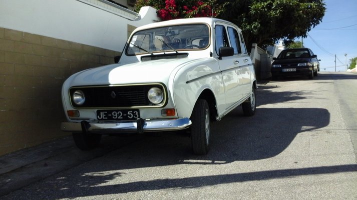

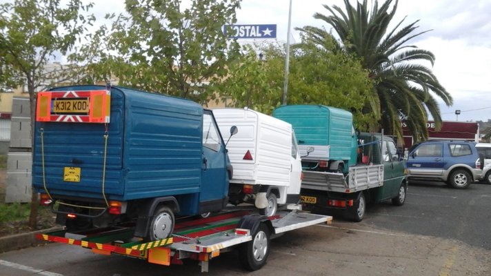

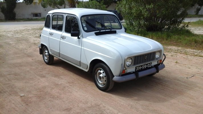

I occasionally put a small amount of Castrol R in the fuel tank, it has the same effect I guess Reid, and it smells great too.
I always have 5 litres of 2% petrol/putolene 2-stroke racing oil ready mixed in my shed (ready for the Apes)
After the tips in this post, I'll also be pouring it into my Renault 4s from now-on.
Brilliant, thanks lads,
