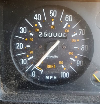

    My 956cc has 250,000kms on the clock, appears to be original, looking closer it looks like it was loved, Oil changes must of been regular, and I'm following on with loads of tlc...
