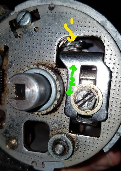

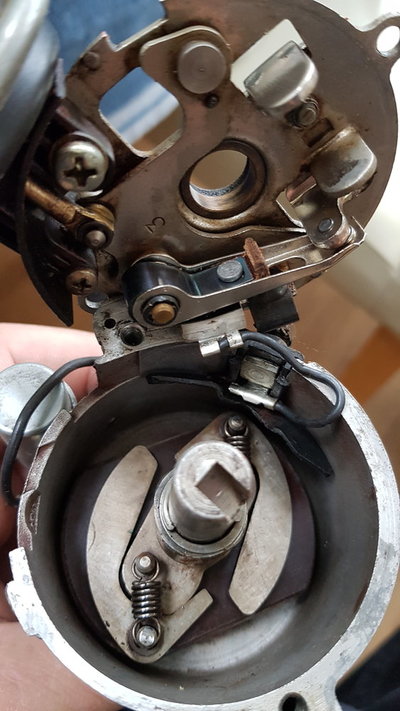

how to put contact-breaker heel on cam lobe?
I have experience with fitting and adjusting contact-breaker points on Ducellier dizzy.

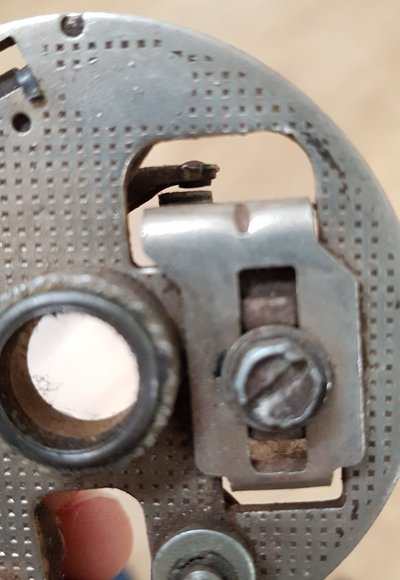

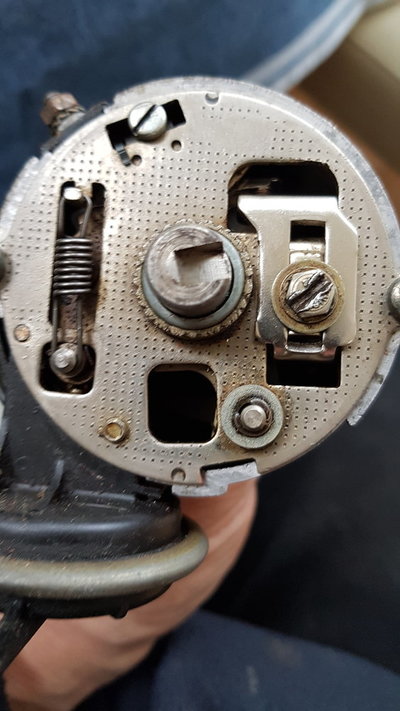

I've had a couple of GTLs that originally had Femsa distributors - I used to find it easier to take the distributor out of the car to change the points, as you can then turn the distributor by hand in either direction. Whichever way you do it - distributor out or in, it's a lot fiddlier than with a Ducellier (although if it's a Ducellier with externally adjustable points, you have to take it out of the car to change the points anyway).
How to contact-breaker points are held fully open by one of the cam lobes...or adjusting the gap.
That's my question...
As I said above, you can do it with the distributor in or out of the car (if you remove it, take a photo of the position of the rotor arm before you start).
If it's in the car, turn the engine in the usual way so that the moving part of the points (1) is as open as it can be. then adjust the fixed part (2) with a feeler gauge, again in the usual way.
It's easier to turn the distributor shaft and feel/see if the points are fully open - and therefore that (1) is on one of the cam lobes - if you remove the distributor from the car.
@Andy McGhee ok, thanks.
Conclusion.. cam lobe can't be centered visually as with D. I must check max gap between the two contacts.
