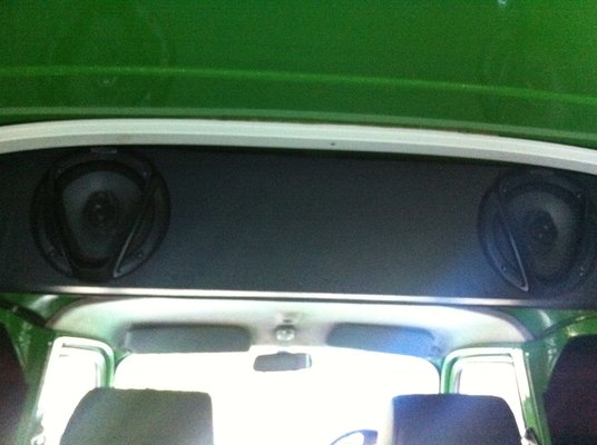

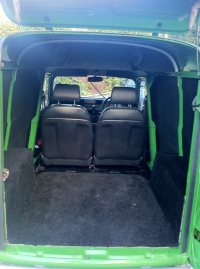

Best place to put speakers in my opinion would be in the frontmost part of extended roof then they will end up out of the way ,nicely behind and rear of your ears
so low volume is sufficiant. if you have to cranc up volume on most car-stereos you end up listening to at least 10% distortion... -Reid
I have speakers in the A-panel areas at each side of thefootwell and also pointing back into the cargo space in the roof.
