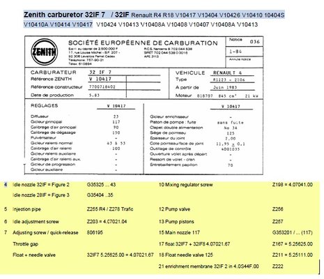

Sorry for late answer, i was away from forum for some time
What do you need from picture below? My english is not so clear and often i mix some common names for parts that is actually caled differently in literature
I have recently found idle screw (NO4 on picture) for zenith 32if7 on french ebay.
http://www.ebay.co.uk/itm/172338121920?_trksid=p2057872.m2749.l2649&ssPageName=STRK:MEBIDX:IT
This seller has many parts for zenith, solex carbs.
You must be careful which idle screw you need, as it is different for different zenith32if models which was installed on quite big range of renault engines.
They are physically same but hole inside of it is different and you need to pick up right according to carb model.
Here are data that i have.
On top of the picture you have models of zenith 32if7 carb (for example V10417)
And below are codes for parts
I could not find idle screw G35325/43 so bought closest i could find which is G35325/50
Will see how carb will work with it!
Good luck!
Good luck!
