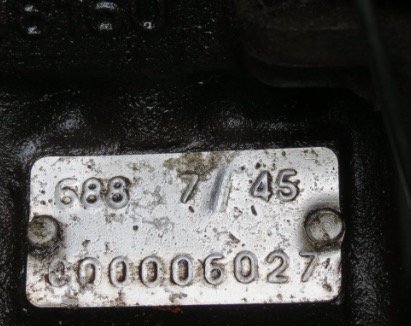

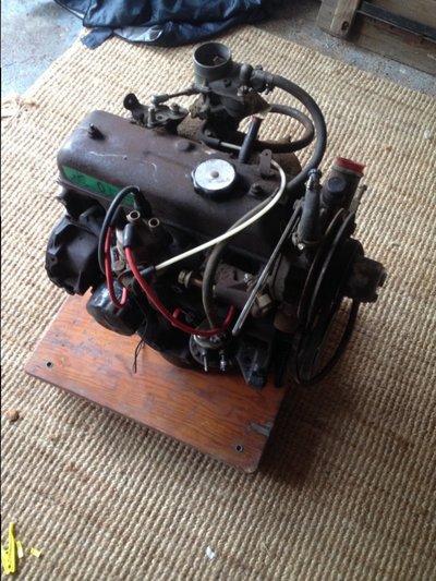

I shall reveal all later :o but I have the good fortune to acquire a lovely GTL engine in amazing condition. Reading past threads about the fabled Hennessy Hot up kit I'm interested in doing same/similar .

Looks nice. Is that an early GTL engine? I Think you can just plump it in as it is. Maybe do the jets and have a go at it.
Same as GTL yes but intended for something else - to be revealed!
Well its is a 35 HP engine, the complete reveal is for you.:clapping:

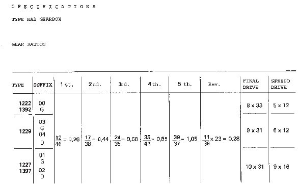

There are two 5 speed gearboxes (HA1-01 and HA1-03) that can be put on R4 engine.
Difference between these two gearboxes is in final drive.
Gearbox that you need to find has same final drive as R4 gearbox (HA1-01)

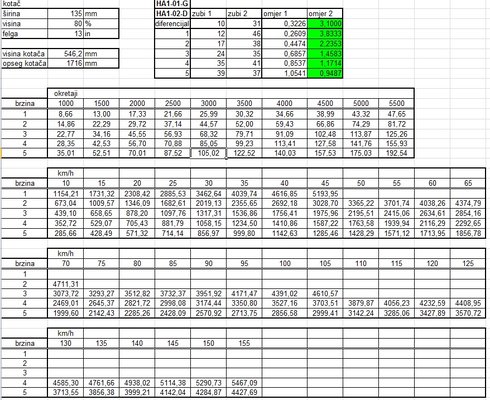

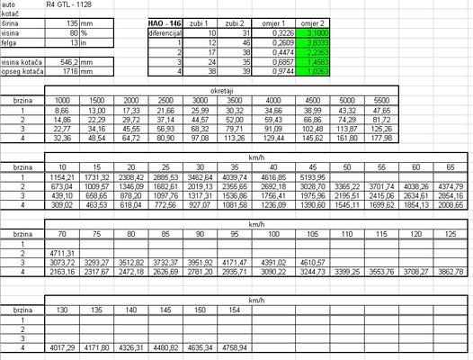

I was calculating (teoreticly) speed in different gears at certain rpms for HAO-146 (R4 GTL gearbox) and HA1-01 gerabox.
Here are ratios for HA1 gerbox

Here are calculations for HAO gerabox according to rpms and km/h
Here is same calculation for HA1 gearbox

Theoretically you can gain only if your driving speed is around 90-100-110km/h
R4 with HAO gearbox is running at rpms 2781 (90km/h) - 3090 (100km/h) - 3399 (110km/h)
R4 with HA1 gearbox is running at rpms 2570 (90km/h) - 2850 (100km/h) - 3140 (110km/h)
Looking at these numbers i would say that there is no big benefit from HA1 gearbox for pleasant and smooth drive, possibly to petrol consumption but not for racing up an R4
Sorry for excel sheets in Croatian but numbers are the same in English
Personally, if i manage to get to one HA1-01 gearbox i would try to fit it in my R4 to see are these theoretical number somewhere near real numbers. If they are it would meant much to me as my daily drive is at open road so 80-90-100km/h speed are normal and desirable.
