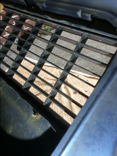

Ive been working on something similar. Ive made two bits of steel wich sit behind the grill on the lip and then screw the lights through the grillinto the lights.
Between the bits of steel and the grill, on thi inside I made two bits of wood theat fill the gap between the steel and the back of the grill so I dont pull the grill back and snap it.
Will send photos

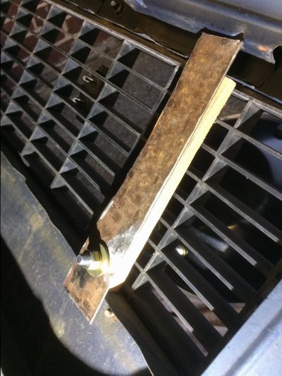

Photo 1:
This is the view of the back side of the grill from the inside of the car.
Notice around the grill is a lip of metal. this is the key to holding the sportlights.

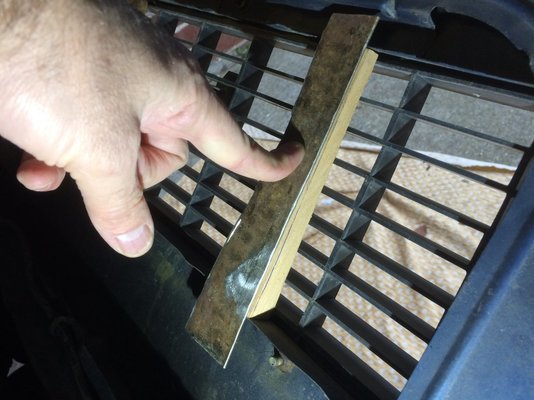

Photo 2.
I made two Shims of wood that fit inside the lip and are the thickness the same as the lip of metal top an bottom. these are just slotted in

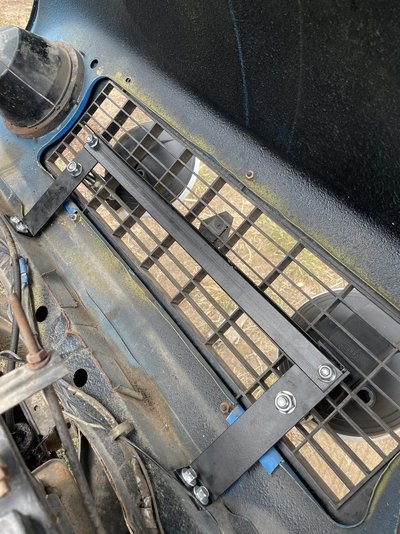

Photo 3.
An inch wide bit of steel that is long enough to sit on the lip of the metal surround and over the wooden shims.
Now from the front of the grill mark where you want the hole of the nut to go through that will hold the spotlights.
My hole was the very bottom hole in the grill.
I then remove both shim and metal plate and drilled a hole in both
Then put them back and put the spotlight holding bolt throught the shim and the metal plate and put a nut on the back.

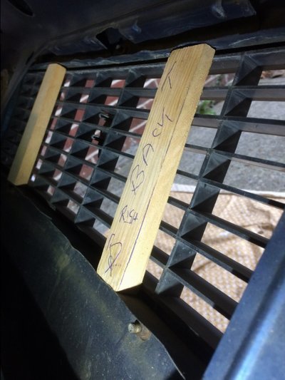

Photo 4.
Nut in place Spotlights secure and most importantly of all, not putting any pressure on the grill.
Happy rallying

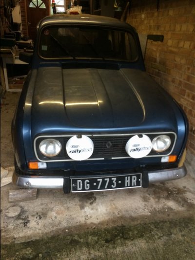

Only a month to go before Chrisitne an I set off for Austria and She has her snow tyres and rally lights in place. I think I ve thought of everything but if anyone has anything I might have forgotten about driving in snow an ice an cold weather please let me know.

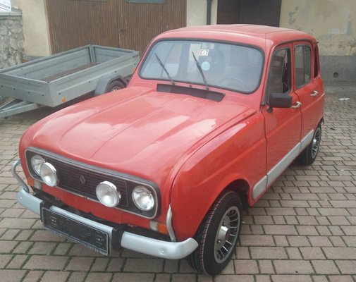

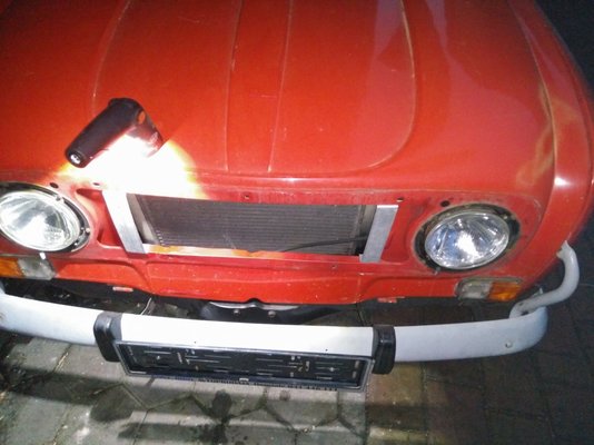

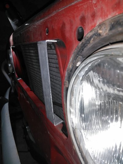

My way - every ALU holder I screwed with 4 screws.

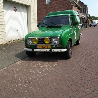

Did mine the same way as Sprackers (with slight modification) It works well
