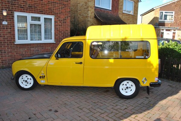

Thank you for that Petak.
Went to look at an F6 yesterday that had lowered suspension. Wondered how it had been achieved.

Hi Tom, as you can see from JdeWs comments, it is quite a job to adjust the ride height on the 4. The front can be adjusted by dismantling the suspension, so you don't need the special tool for releasing the tension. As petak said, the rear can be problematic as the bars can seize in their splined holes. Also if you go too low the ride becomes harsh, and you loose that beautiful soft ride that is part of the charm of the 4. Your lovely van looks good as is.

Hello Brian
Went to look at the F6 yesterday with a view to purchasing it.
It has already been lowered and I felt there was rubbing on the front when we went for a test drive.
If I get it may well consider going back to standard ride height.
Regards
Tom
Ah now I see Tom. I should have read your previous post. Yes it does look a bit low, but otherwise it's looking good, yellow suits the 4. As the suspension has obviously been disturbed to lower it, it shouldn't be too difficult to reverse the situation, just time consuming. But as like me you seem to have a little time on your hands you can nibble away at it can't you.
Regards Brian
