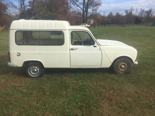

Yeah it would have been imported personally by someone. The seller said it came from the south of France. He daily drove it up until 3 years ago(used for farm work around town).
I would be happy to have any tech info at all for the r4's...:waving:

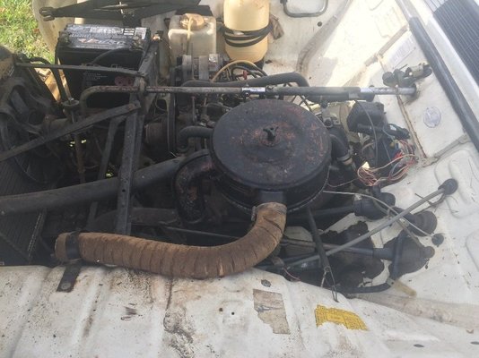

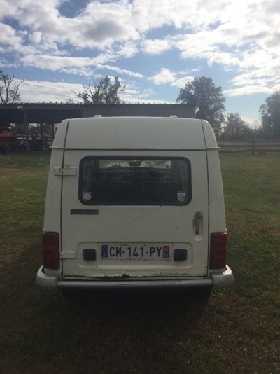

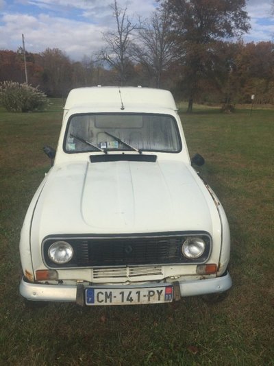

Congratulations with such a rare find.

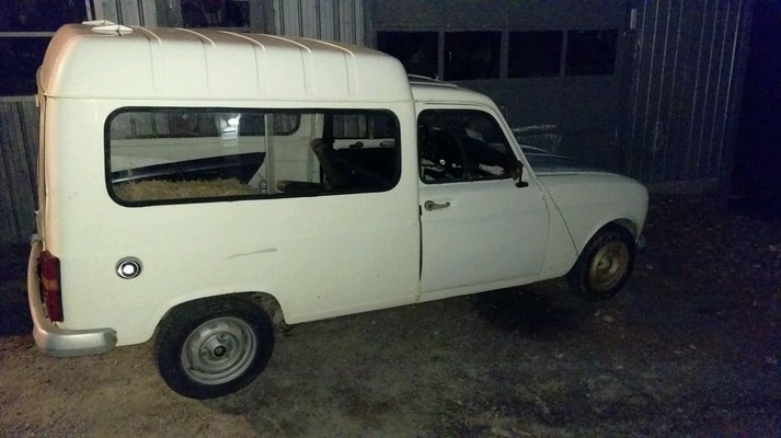

Even here in Europe the F6 is proving to be a rare car. Normally they have been driven and abused until they fell apart.
the car you have looks like a F6 from the seventies with the hinges of the front doors on the outside of the body. All the F6s have a Cleon 688 engine, an 1108cc workhorse. If you are lucky it has a 32 mm carburetor that it delivers about 35 HP.
It is not fast but it delivers quite some torque for such a small engine.

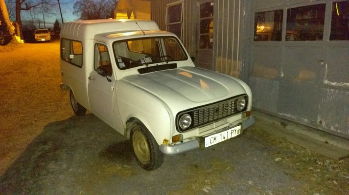

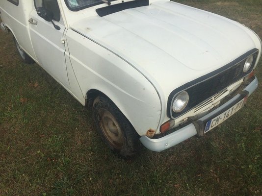

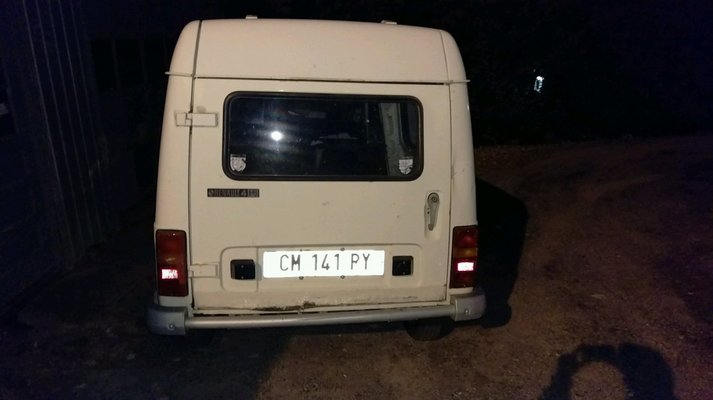

No video yet, but a few random pictures.
Has a new radiator, and a good bit of other parts with it. Even two good front fenders. Need to find a muffler, and head light bulb now.
Will a standard r4 muffler work on it?
Also thanks petak for the manuals- these really help!

Hey Adam, no a GTL mufler wil only bring you grief.
You need to get the exhaust fumes to the side of a F6.
If you put a standard exhaust on it, the fumes will enter the cabin throug the gaps around the back door and girafon.
Opening the window will make things worse and you'll be gassing yourself in the process.
Unfortunately I'm speaking from experience.

I yanked off the rotten left fender. The rust stopped right at the seem---YAAAAAH! ;) New fender looks perfect.
I found the exhaust parts picture in the 1104 book. I thought it was a bit fumey sitting at the stop light...

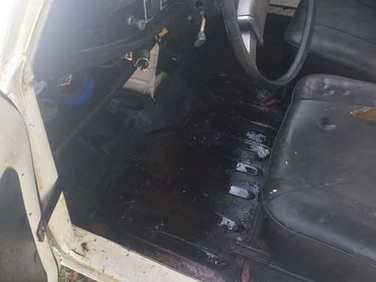

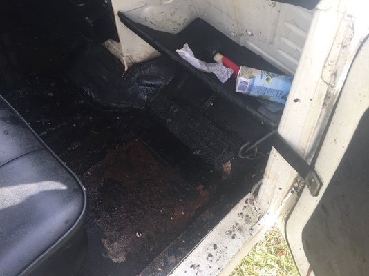

The worst rust is of course the front floor area. Might need more than fiber glass, and epoxy paint on this one. :scared:
Thankfully the rust is well clear of any mountings.
