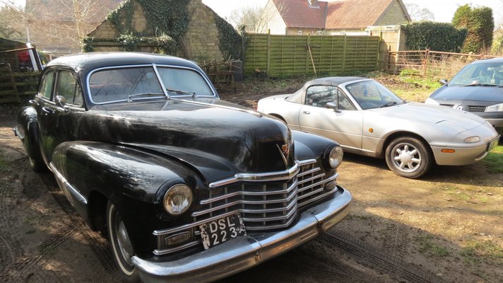

Will persevere on this engine for now and take your advice regarding parts. Here is my 1942 GMC also got a '43 Ford Jeep and just sold a '46 Cadillac.
