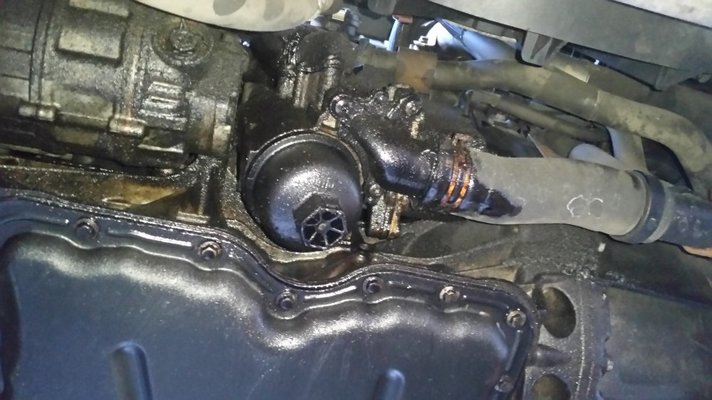

I currently own a 2008 renault laguna, which i have had for the past couple of months. Just realised the car has oil leak, can be seen on the sump. Looking from the top everything looks fine but when looking underneath, it has fair amount of oil. The car does not smoke but figured some oil was also in the turbo breather pipe. Please help as i have spent lots of money on the car and local garage cannot figure out a problem. I have attached a picture.20150607_105532.jpg
Looking at the picture it appears the oil leak is emanating from the oil filter housing. The circular black plastic housing with the hexagonal drive on the end is the oil filter housing, inside which is the oil filter itself. When the oil filter is changed there are two rubber seals, which must also be changed. If they are not changed the filter housing will leak. in addition it is easy to cross-thread the filter housing when putting it back (I did it once!)
Before panicking and thinking the turbo is damaged I'd carry out an oil and oil filter change and while under the car carefully clean the area around the filter. Make sure the filter is correctly seated and fitted properly and that the correct grade of oil is added to the sump. Before starting the engine wipe the area clean and se if there's a leak before starting the engine. If there's no leak then start the engine & check for leaks around the filter.
Happy to offer more advice if needed!
I am very grateful for your reply and i will have that changed asap.
But is there meant to be little bit of oil in the turbo breather pipe?
Not from his point of view. We had a long chat on the phone & Imran took the car to a Renault specialist, who diagnosed a problem with the turbo. I should add that it's not also easy to diagnose a car's problems without seeing it "in the metal" and the advice I offered was with this caveat. The images Imran posted on the forum suggested an oil leak from around the filter housing, which is a problem I've encountered in cars with the newer type filter housings. He was grateful for my help and advice, even if it didn't turn out to be what I had thought it was!
