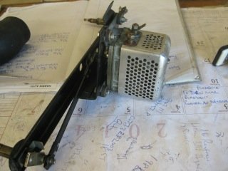

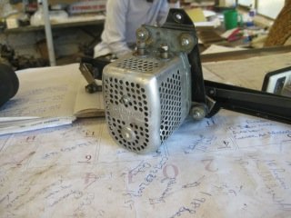

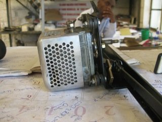

Thanks for your reply and suggestion. This is a photo of my non-working wiper motor It is 12 volt. Maker: SEV MARCHAL.
Using a voltmeter you could also check if you have continuity in the windings, which if you DON'T have could mean condemning it. That said, the brushes are a racing certainty to be the problem.
