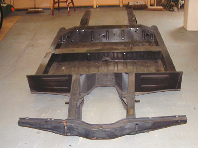

I started to dismantle the new chassis at the beginning of september, I removed the soundproofing material glued to the floors (wich keep the water and make the floor rusting, I won't put them again when I will reassemble the chassis), the front floor seemed to be in good condition at first sight:
But after scratching in every corners I saw several little rust holes :eek:
The rear floor was in good condition too but it had very little rust hole too :shock:

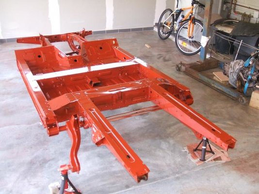

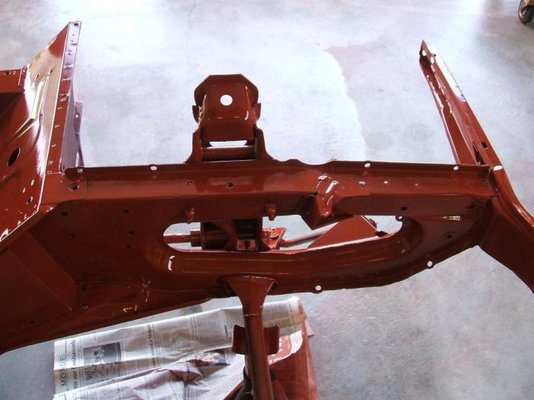

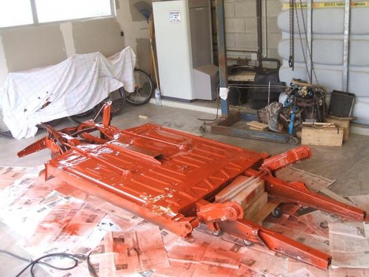

:cool: Hi all, here is the following of my restoration. I decided to start by the underneath of the chassis, after hiding all the nuts and bolts, dusting the surface, I spray a first coat of Rustol CIP:

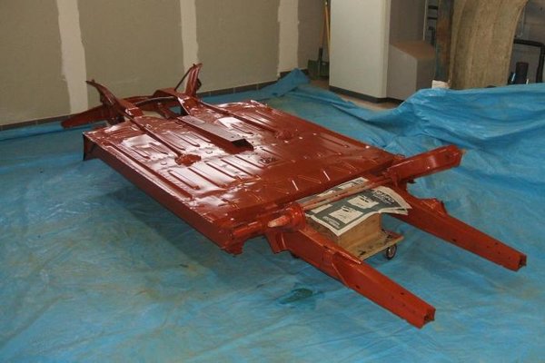

:D Then I returned the chassis and finished the first coat.

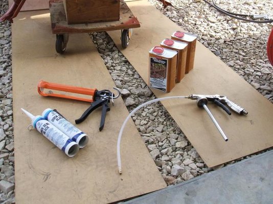

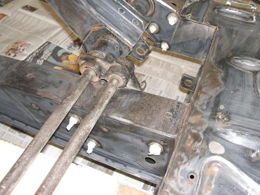

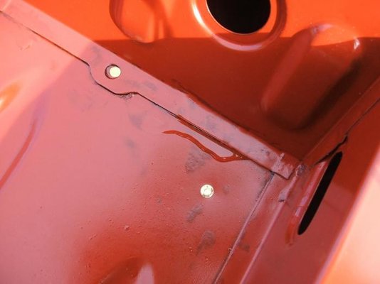

The Rustol CIP is a very good product but you have to wait for a very long time to be sure it's dry, so after one week I decided to treat the inside of the chassis with another Rustol product: Rustol Owatrol. Every place has been treated with it, even the rear arms (which are in steel metal known to be more fragile than the other type). On the third picture you can see the Rustol Owatrol passing through the two parts of the chassis, I am absolutly sure that all the little places will be protected:
:smile: Another week to wait for the drying, after it, I will apply sealing on the chassis before primer PPG...

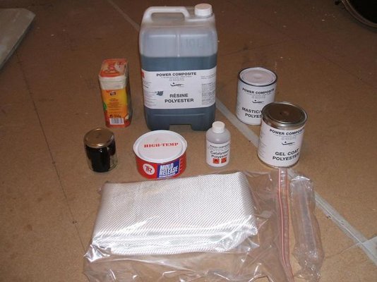

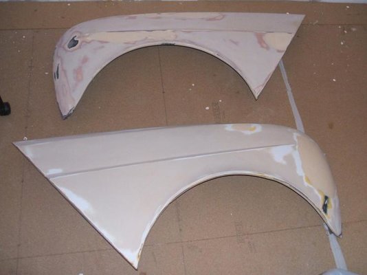

Just a little break in the story of my chassis, today I bought material to resolve one of the biggest problem of our lovelies R4 : rust. I don't want to see my wings rusting again in few years even I did all that I could to protect them. This is the reason why I decided that my R4 restored will have its 4 wings and the 2 "doublures avant" (sorry, what is the english word please ?) built in fiberglass.
Firstly, I gave to my coachbuilder two second-hand front wings which have been prepared. I'm going to build moulds around them, then I'll make my front wings in fiberglass :smile:

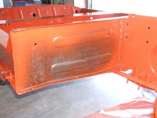

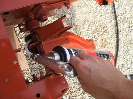

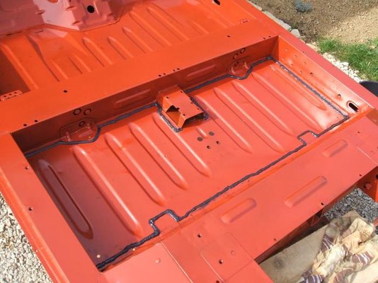

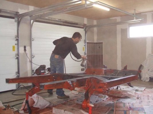

After waiting for 2 weeks to be sure the first coat was dry, I put a sealant at every corner of the chassis:
This type of job is not very pleasant because every time I do that, I use my fingers to apply the sealant and it's very, very, very dirty...
Compare to the first coat of Rustol, I decided to put tarpaulin on the garage floor to prevent dirty marks due to the paint frog:

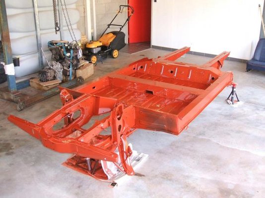

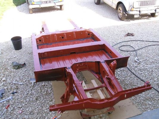

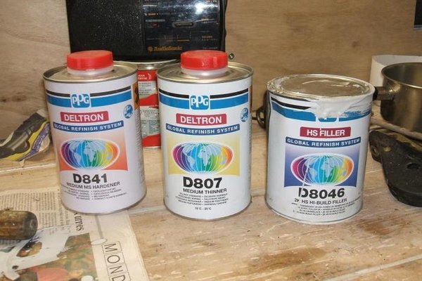

Here are the PPG products I used for the last primary coat before black paint:

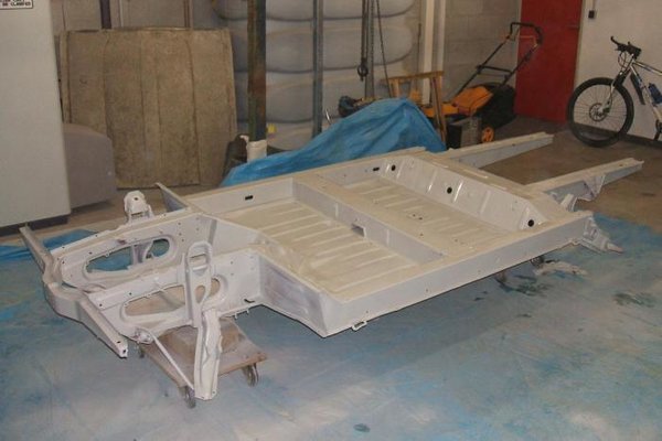

Few moments later the chassis was painted, nice isn't it ?

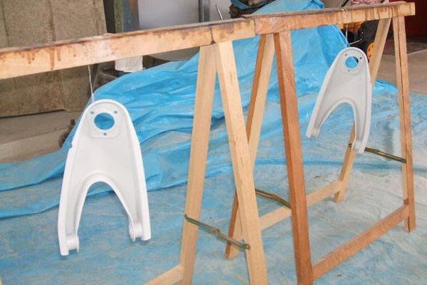

At the same time the wishbones have also been painted, I didn't change the bushes because the chassis has only 51000 km:

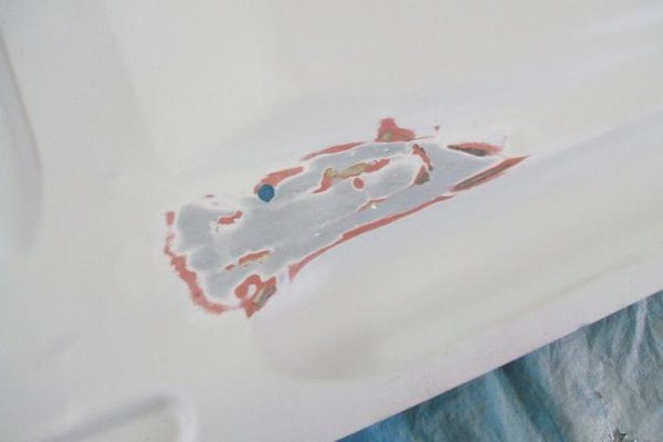

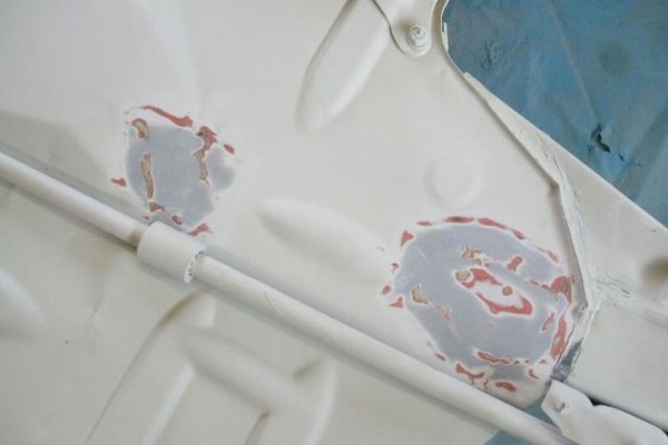

As I said above, I decided to use filler to finish the surfaces where patches have been welded. Not difficult and after that the finishing touch is perfect:
Ready for paint now ;) ;)
