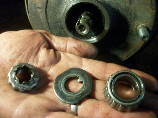

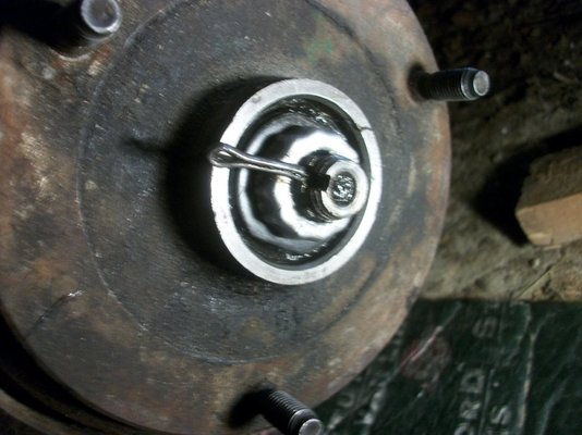

Hi Neil, taking the rear drum off is far easier than the front.
Firstly you'll have to get the dust cover off by knocking it gently from all sides with a rubber mallet or a piece of wood. Then remove the split pin and then the castle nut, which is only finger tight.
