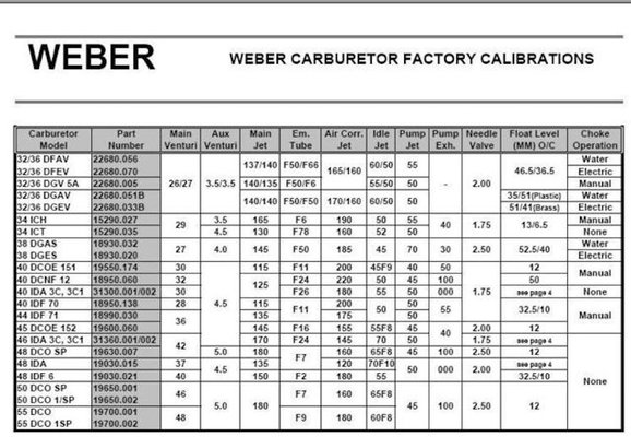

It might be worthwhile to get an emissions test to see how much unused fuel you're pushing out of your exhaust pipe. I've also found this chart for you to make sure that your jets are the correct size.
I also think that if your air jets are to small or blocked, then you'll use more fuel
