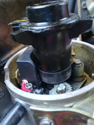

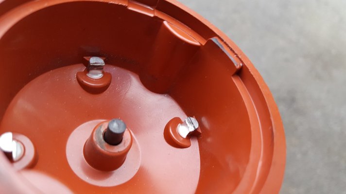

    So after fitting the accuspark kit an update, at first all was well it ran like a dream but then started miss firing, on closer inspection the rotar arm was not sitting low enough and caused it to wobble and cause damage to the disi cap taking chucks out of one of the internal terminals carving it out. I spoke to accuspark who said it's a common problem and there wasn't a fix and to return it to them for a refund, so tonight I have removed it and reinstalled the points and set back up, all working well following the manual set up posted the other day, it's too late to test drive but a new rotar and disi cap installed let's see how she runs. A little disappointed that the electronic ignition was a failure for me but glad I kept all the old bits..

    I would be grateful if you could post picture of that destroyed cap. From inside.

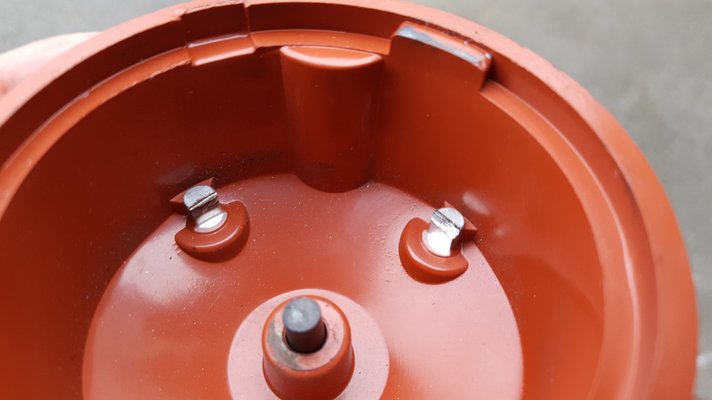

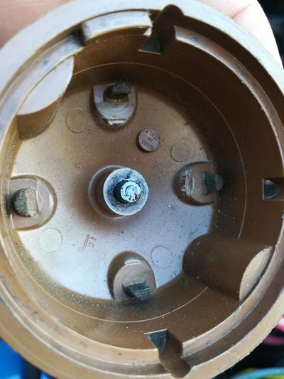

    I replaced the rotar and cap with a new one when I replaced with electronic ignition, pictures below of the damage, replaced now with a new cap and rotar, set up the points at 0.40mm with a dwell reading of 50degrees and correct timing, runs well and pulls nicely.

    That is to much grind of.
    I am really surprised. :o
    Can you measure height of that cap?
    I can not understand that my is working alright and yours is destroyed.
    What is your distributor tipe?
    Sorry to disturb you but would like to find out what is reason for yours to be destroyed, and mine is working nice.
    Thank you!

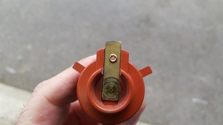

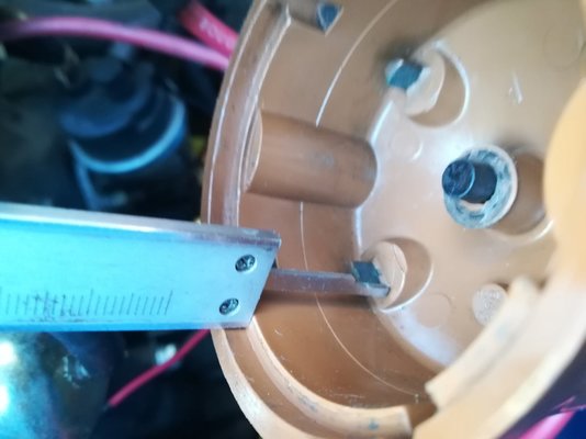

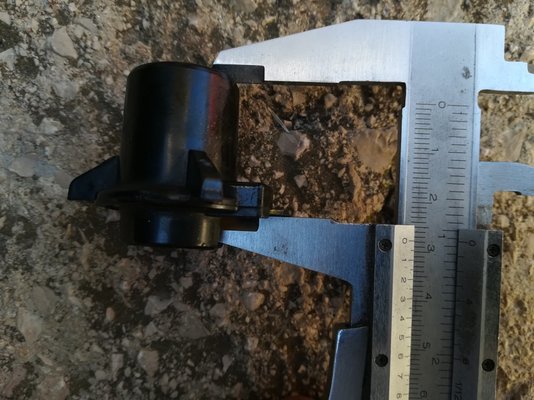

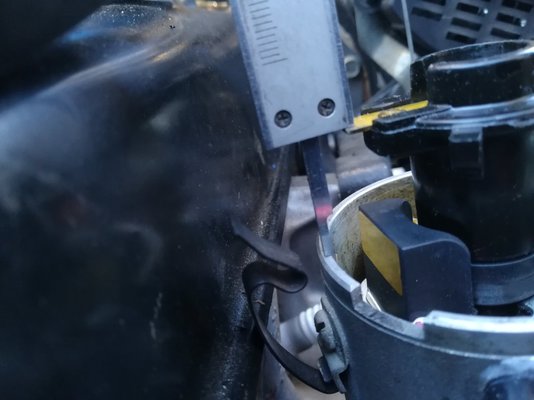

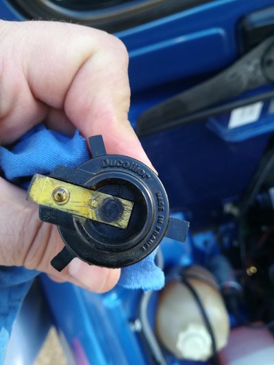

    Have measured mine cap and rotor.
    cap is some "noname"
    rotor is Ducellier
    You can see damage on mine cap from inside. After i have noticed i just pressed rottor little bit more and since than there is no problem any more
    rotor arm
    Rotor height from bottom to metal 28mm
    When you place rotor where it should be
    distance from dizzy edge to the rotor pointer is 24mm
    distance from cap edge to the pin base inside cap is 26mm
    So there is 2 mm gap.
    Pins inside cap are 50mm apart. 25mm from pin to center of the cap
    From center of rotor to end of pointer is 24mm
    So there is 1mm gap between pointer on rotor to the pin in cap.
    I am waiting your dimensions to campare
