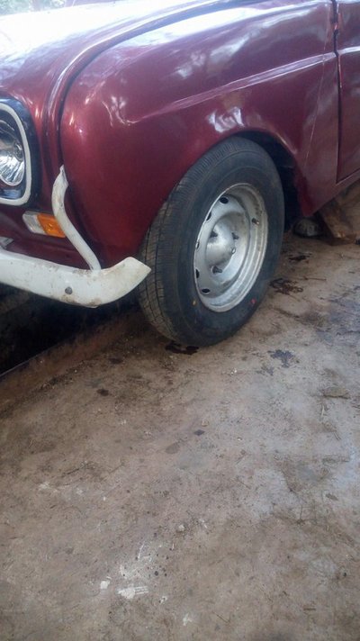

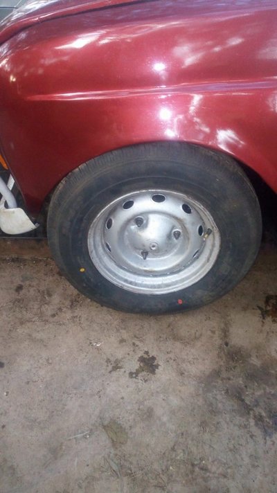

Hi all
I have managed to set the ride height of my 4tl using torsion bar adjustments. However, once I set the ride height, it only holds for 10minutes and then collapses gradually until the whole tyre is sank. But this only happens on one side of the car. I am not sure what could be causing the loss of height. Please help
Eh?!
Could it be something fundamental like the torsion bar is able to rotate as the teeth have gone at one end ? Or chassis corrosion??
