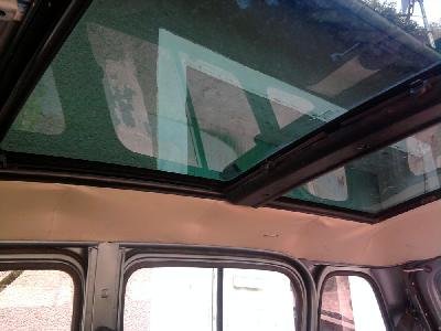

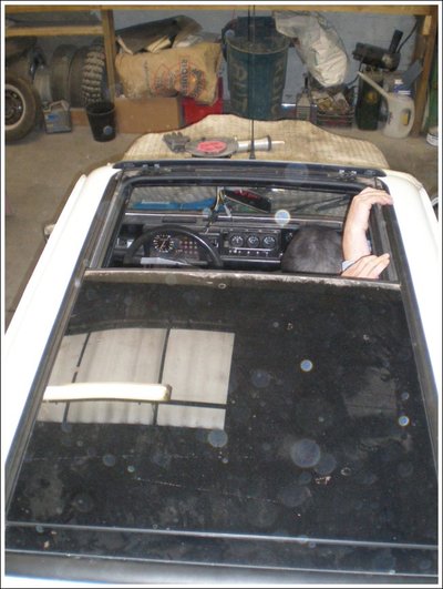

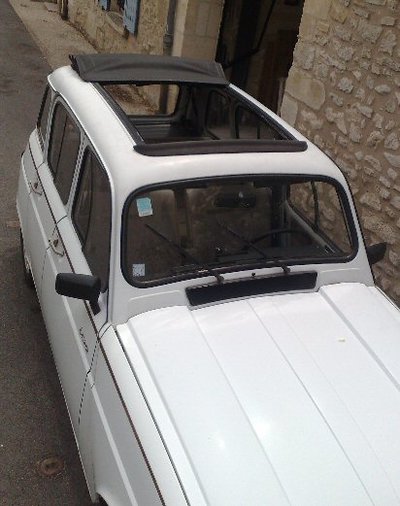

Has anybody tried putting a Twingo sunroof on the R4?
They seem to fit better on the R4 than the webasto ones, which are too short for the length of the roof.
There is an electric panoramic one from the Twingo too - Does anybody have experience of how well this fits?

I have two friends from Belgrade who fitted Twingo sunroofs on their R4's. They say it was a straight job and that it fits well.

I'm only slightly confused!. The fabric one in the photo's is a Twingo sunroof?, as is the glass one?, you would like to fit the glass one?.

Both of them, the glass and the fabric, are from a Twingo Mk1.
There are plenty of them on leboncoin.fr
Bison may have a problem though! As Far As I Know, both the glass and Fabric roofs are made by Webasto! The glass one on Judiths latest Twingo certainly is!
Hi I met a french man at Reims this year who had fitted a fabric twingo sunroof in his 4.

But having had both types of sunroof on our twingos, I'd go for the fabric one every time! It is an ace design, it clicks back half way or can go all the way back. The glass one by its very nature is only a half way opening.
