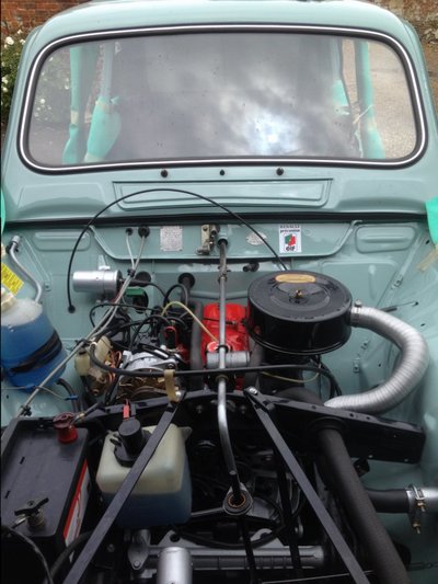

Stick a little electronic ignition unit on it and throw that condenser away! I'm really sold on mine. It's the little green box smaller than a matchbox attached to the coil. The points are still used (for the time being anyway) the points simply supply a pulse. There is no tension across them so they don't wear out electrically nor do they need adjustment
