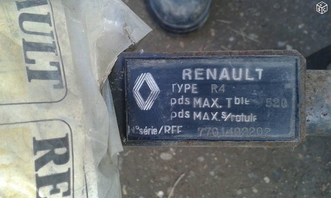

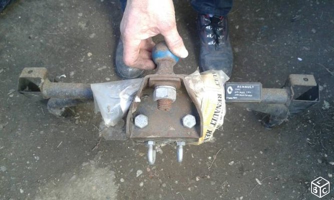

Here's something that you can scratch your head about.
It's an advert that I saw on LeBonCoin last night.
It's a Renault tow bar and it's for an R4. But I don't know what "pds" means or if the "520" is Kgs or pounds (lbs)
I also don't know if it means that the tow bar has a limit of 520pds (before it breaks) or if the car itself can only tow 520pds
I'll leave it to you to work out:laughing:
This looks pretty much like the tow-hitch fitted to my 1987 GTL, a French registered car with what seems to be an original hitch assembly.
