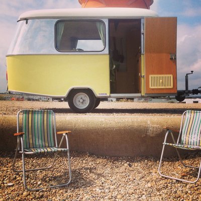

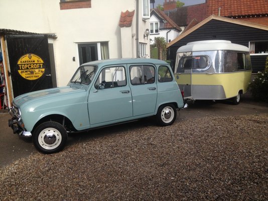

If you have an 1100 engine there should be no issue pulling a trailer tent. My GTL pulls an Eriba Puck Caravan very well. Even with 4 of us inside and up a 1:10 hill !
Eriba Puck? I believe the early unbraked version was a fair bit lighter and could even be towed by 2CVs. I love them.
