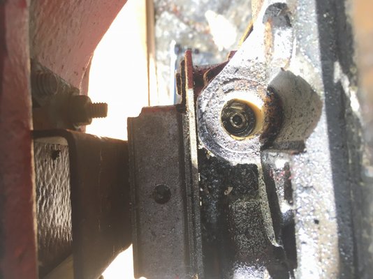

I think my r4 is leaking gear oil, so i change the oil with gl5 because my gearbox is HAO and i found a bolt close to the speedocable unscrewed, so i thought it was there the leaking and i screw the bolt, and now don´t read the kilometers and the pointer on the clock doesn´t move. Before i do this this pointer works in a shaking way. I unscrew the bolt for the original posicion but it don´t works... What can i do now? Maybe i have done some damage in the speedocable?this bolt unscrew it´s a kind of affination? how can i check it? Can someone help me with any advice or tips?
Here is a photo after i scre the bolt:

Hello Sutree, welcome to the forum, and the wonderful world of Renault 4. I think what has happened is when you unscrewed the bolt the speedometer cable has lifted and has become disengaged from the mechanism in the gearbox. Unscrew the bolt and try pushing the cable back, you will hopefully feel it re- engage, and then re-tighten the bolt. The oil leak is probably from the gearbox end cover.
Hello Sutree
The bolt that you show in your photo is the correct one for the speedo cable.
if you unscrew it you should be able to pull the cable out. If its a bit stuck, spray some WD40 in there and try to clean it. Old oil and dirt are probably holding the cable in place. Just give it a hard pull and wiggle it a bit.
Also once you have the cable free, try to lubricate it by spraying some oil down the cable sleeve. Also clean around the area where the end of the cable fits.
The end of the cable fits into a gear, so make sure it is properly seated when you reinstall.
Good luck!
(Snap Cornish!!) Again!
Cornish and mojobaby thank´s for the tips, i will do it soon! Maybe i can fix it like you told. I was scared if i had broke the small weel or buterfly (i don´t know the name) inside the gear box while i screw the bolt. So there´s no problema screwing this bolt? right?
Thank you all.
Hi Sutree, you have to unscrew the bolt a little to take out the cable.
The end of the cable fits into a nylon bush. When you pull the cable out, put your finger on top of the bush and hold it down while you pull the cable.
If you don't hold the bush down it will come out with the cable.
Then clean inside the hole, put the cable end back into the bush and press it down into position.
Then you can tighten the bolt again, but not too hard. Just so the cable stays in place.

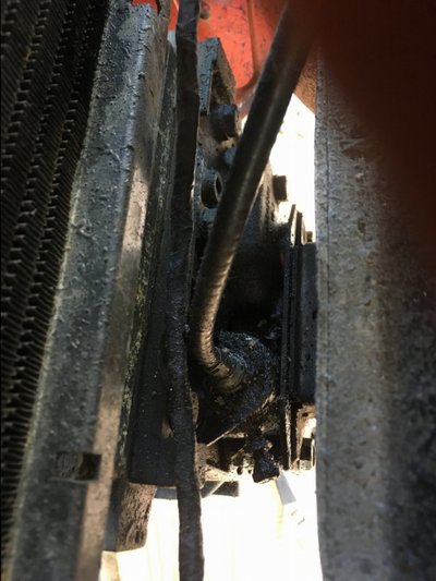

Hi there! Finally a had time to fix the speedcable. It was hard at the moment because the cable disengaged at the dasboard, but with a litlle help of my wife i put it right in place, then i checked it if it was breaked with a drill and the cable run perfected. So i engaged again and it´s pretty fine for the moment. In any case here´s a picture of the nylon bush after i puch the cable off. There´s some steal snack´s because i screw to much and damage the end of the cable. But it´s ok now.
