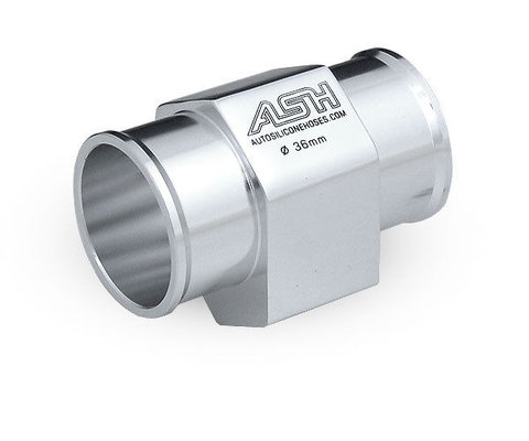

also there is this adapter to "cut" into your radiator hose on ebay 190896748826
then just buy a ? BMC Mini temp gauge and a BMC Mini temp sender unit or similar so they match up...........my thermostat was removed and not replaced like most vehicles here in Cyprus, we dont take the chance of them failing in the Mediterranean heat :cool:
This adapter is useless if you have a thermostat (it should be fitted after it, so you will not be warned if the thermostat fails).
I have never had a problem with thermostats in our equally hot climate. It made no difference when I removed it (as expected) so put it back in.

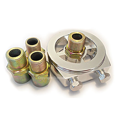

Thanks Angel, I know if the thermostat is fitted this type of system will not warn you of the temp in case the thermostat fails but I want a temp gauge fitted and the sensor in the R4 will not operate a gauge. With the thermostat removed and this "in line" pipe and sensor at least I will have some idea of the water temp in the engine........I also have one of these oil pressure "sandwich" ordered to put between the filter and the block to be able to fit an oil pressure gauge and oil temp gauge.........It even allows for an oil cooler to be fitted !!
I was going to put a "T" piece in but the space between the engine block and the chassis is too tight :(

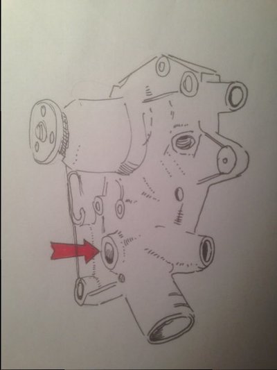

There seems to be different water pumps between the cars and the earlier models have a hex nut in the water pump for a water temp sensor. I've had a look at the water pump on my 1986 GTL but that nut doesn't exist, and I cannot see anything similar. Has anyone else here fitted a water temp sensor to their late model R4, into a threaded hole, and show me where the tapping is? Ta.
(Later) Doh! I've just seen Jonathan's post earlier this month, on the same subject.
(Even later) Solved, I think. I nipped out in between the showers and had yet another look at the water pump. The are two plugs that a can find. A small one on the top (about as big as an old sixpence) and a larger one facing forwards and under the pulley, which will require an Allen key of about 6mm. I think this is the one where a sensor will screw into. So I wonder what size female thread that has?
