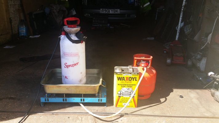

I accidentally set light to my rubber hose whilst warming the garden sprayer on a steel tray full of water over a camping gas twin burner
Not funny at all fortunately I was outside and nowhere near my chassis 20150801_144529.jpg
Best and by far safest way to warm the stuff up is put can or tin in a bucket of warm Not hot water (about 30C does it)
