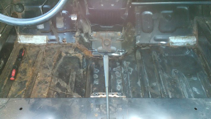

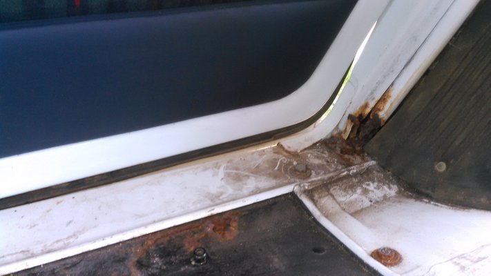

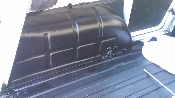

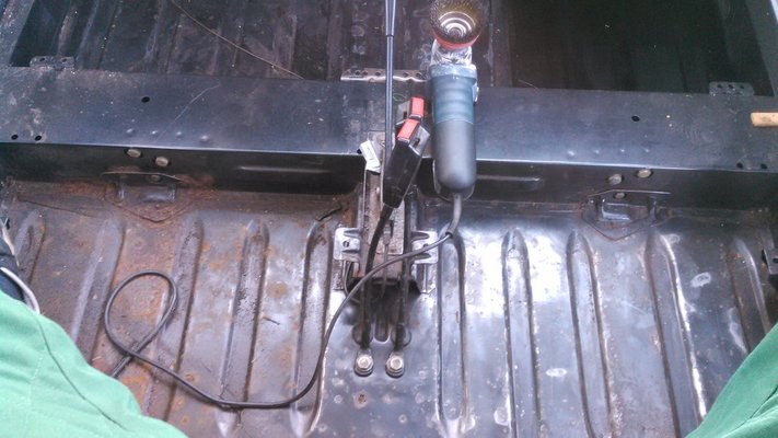

I have begun with the rust on the floor: 20170820_164613.jpg then I'll move to the body on the inside and outside, for the inaccessible parts I'll wait for when i go to align the wheels.
That should be it. The final touches like the paint job and possibly but not probably interior refreshing will be considered, but for the time being, I'll stick with driving it for a while and seeing how it goes.

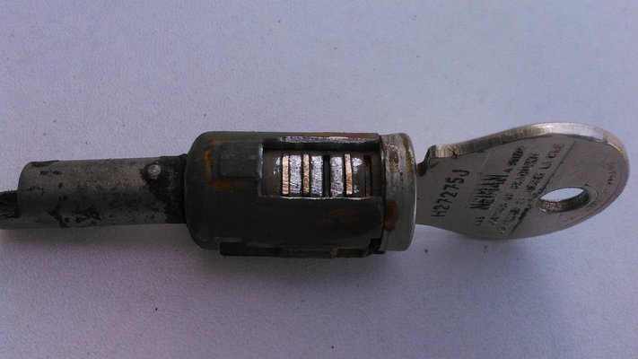

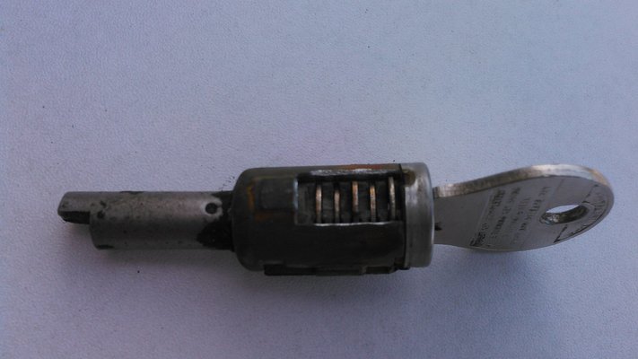

To make a lock without a key functional, you take it apart until you have only this: 20170820_170210.jpg
the key obviously does not unlock this lock, so you grind these pins out while the key is in, on both sides, and you should have something like this: 20170820_170233.jpg
it works flawlessly and does not unlock with other keys.

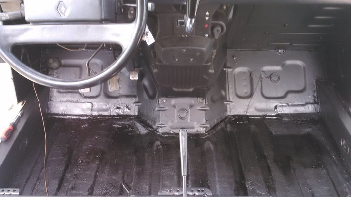

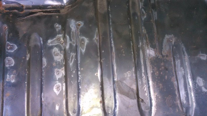

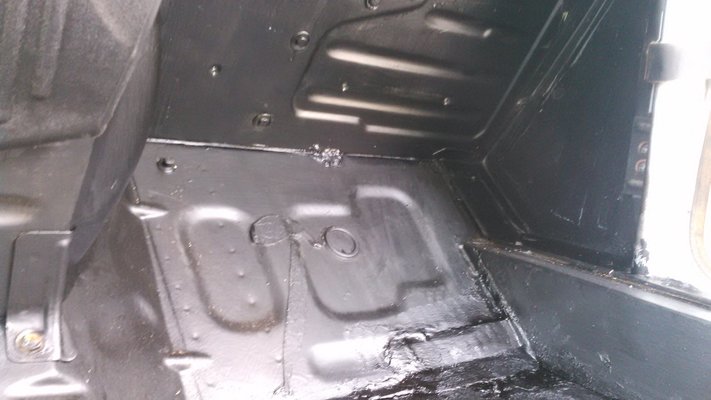

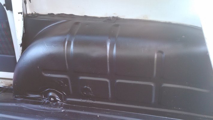

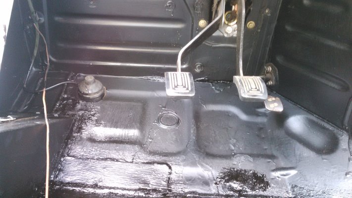

Removed seats and started working on the rusty floor. Discovered more holes.
I have decided to go for the "easier" option and painted with an on rust paint that supposedly seals it and prevents it from spreading further or at least slows it down, after cleaning everything.
I have been told to fill the holes with high grade silicone after that, and as a final touch, to re-paint everything with bitumen. I have meticulously filled every small little tiny crack with that rust paint, and then with silicone. Tomorrow i'm doing the final siliconisations(new word? :)) and then bitumen the hell out of it. When i have the chance, (soon, i hope) i'll do the same on the undercarriage.
When i make my own small garage with lifting capabilities, i will definitely cut out the old floor and weld a new one, and the same goes for every rusty part. Or perhaps i will then disassemble the 4 and do a complete restoration. ...

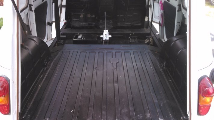

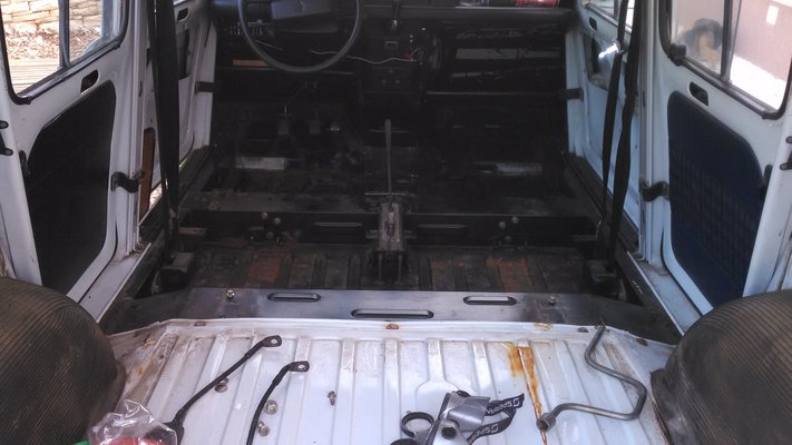

Decided to paint all the way up, i'll use this occasion to renew the bottom plastics since they're off. Wondering if i should just paint them or actually cover them with fake leather...

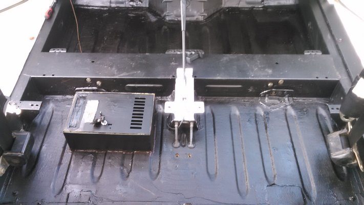

Also, the first thing i decided to do, before even getting a 4, was to procure a safe which i'd hide somewhere. I think it's pretty much safe to say that the 4 is not fort knox, pretty easy to break in.
And old post box was the perfect candidate, changed the lock, painted, and bolted it to the floor. The seat is always all the way back and it can not be seen.
This isn't exactly what i planned, but for now it will do.
The original plan was to cut out the old rusty floor and while putting a new one, incorporate the safe which would indeed be the whole floor. Maybe a bit too high for legs, but there's noone to drive around with me so that would be fine.
Somehow i went further than expected, so i didn't stop, and i like the result actually.

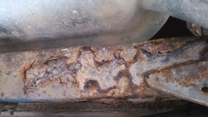

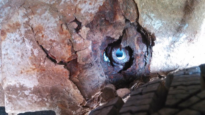

Gotta get rid of this too.
