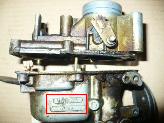

There should be an aluminium tag on one of the lid screws. there are code numbers on it denoting its use. If you list them here, we may be able to help you if your carb is OK for you.
There should be identification number on every carb that can tell you where it is installed. On witch car or engine.
Something like this on my zenith 28IF
Now that I've had a look at the carb, I doubt it was for a Renault at all - 32ISBH 2. I found references for this carb related to Simca/Talbot...
