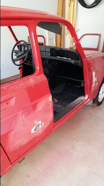

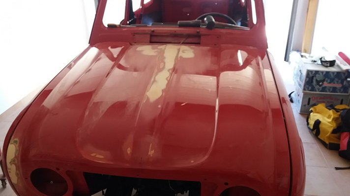

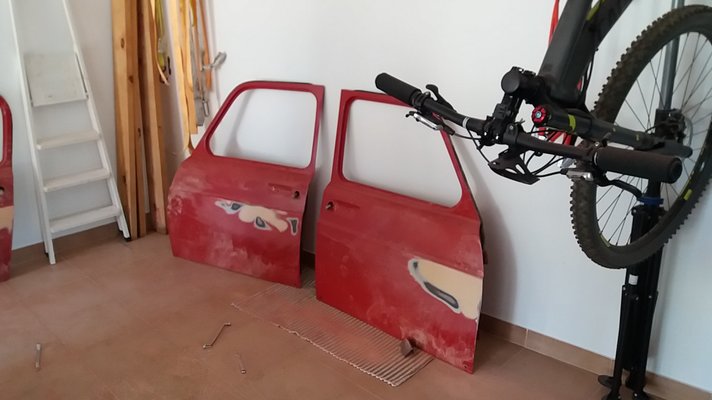

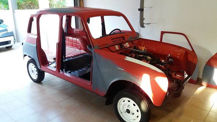

As I mention before, this car was absolutely rust free but it was full of scratches and dents aswell as a dull-ish paintwork.
I started with the strip down and removal of all dents...

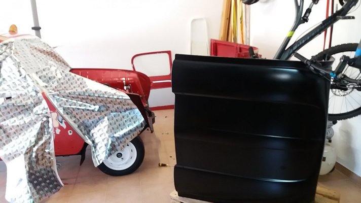

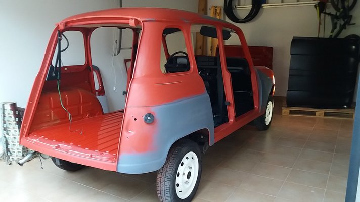

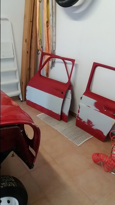

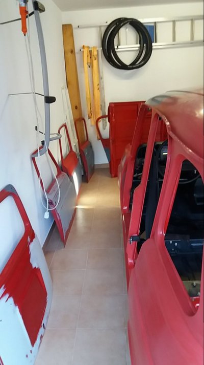

The second stage was to get the body ready for colour. This was definately the most time consuming.
It takes a lot of time and sanding to get the body panels dead straight but it is well worth the effort...

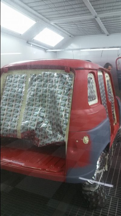

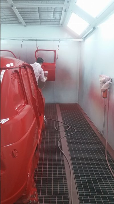

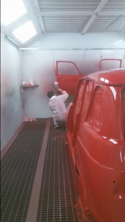

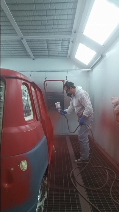

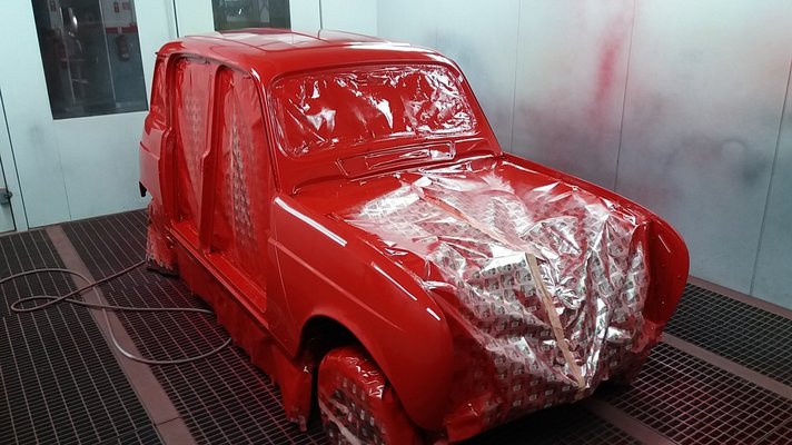

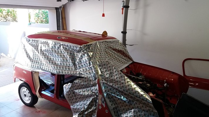

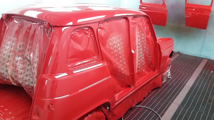

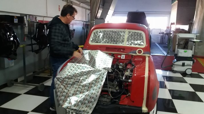

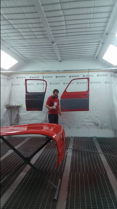

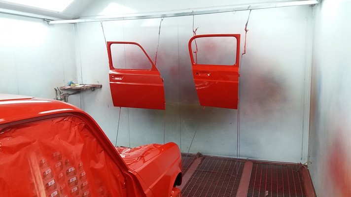

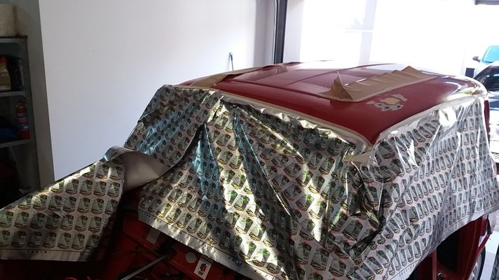

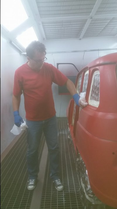

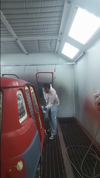

The next phase was to find a paint shop that would do the paint work side of things. It was now late November 2017 and all paint shops were fully booked up untill end of February and that would mean that I could not make use of the December holidays to make headway on the project.
Eventualy , after insisting with a local paint shop owner he said, in an ironical way, that I could paint it myself on a Sunday if I wanted too.
I had not painted a car in more than 20 years but I took it as a challenge and accepted his suggestion...

Almost Ferrari red and now the engine :D.
And that's one nice spraybooth Mike :cool:
Looking fantastic! What I would give to have access to a workshop like that.
Looking forward to seeing it come together
Thank you guys for all the comments, I do appreciate it. I was given access to the spray booth on a Sunday and the owner of the workshop only charged me for the heating costs which was very kind of him.
The colour is the original Renault colour, lucky It still had the paint code sticker on the inner wing.

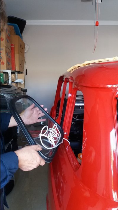

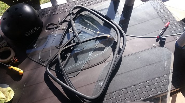

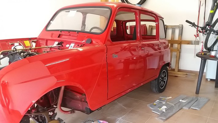

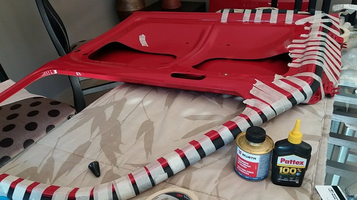

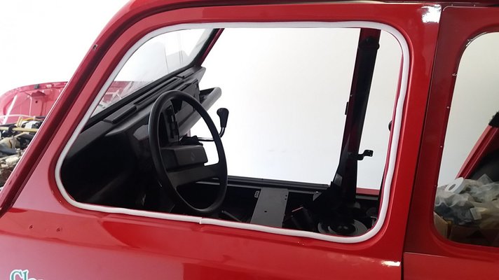

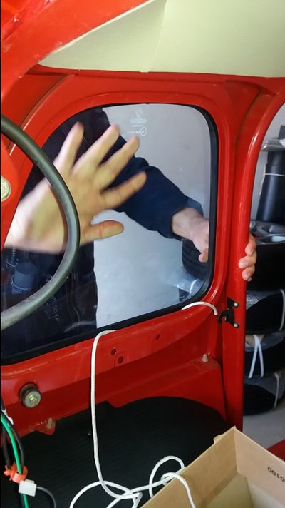

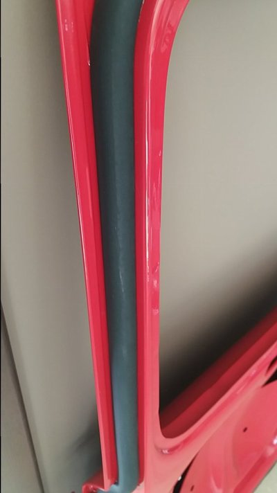

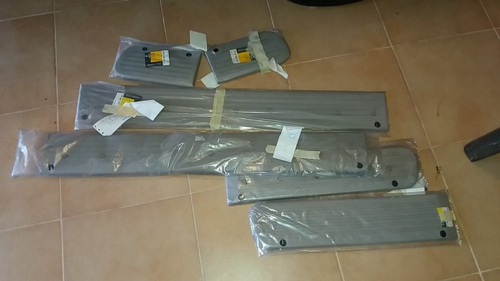

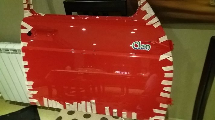

The next step was now to start assembly and I decided to face the dreaded door rubbers challenge.
I fist bought some after-market rubbers here in Portugal being sold as specific for the 4L but they were way too hard. Afterwards I got a set from Der Franzose which were really great and while I waited for the arrival
of the package, I got a phone call from a friend of mine, that works at Renault, telling me that Renault still stock these rubbers. (original) I had to get a set just in case. They also great quality, similar to the ones from Der Franzose.
Regarding the glue, I found the "Pattex 100%" to be by far the best and easiest way to go. It is colourless and it flows easier that the contact glue. Also, it makes for a much neater job and it has a very strong hold.

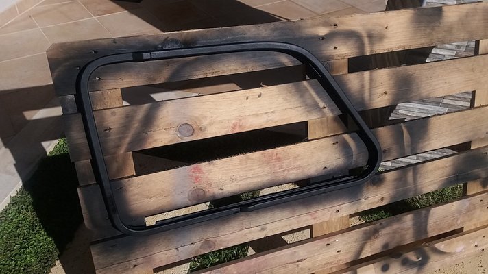

All the other rubbers for the windscreen and door glasses I gave then a good rub with a cloth soaked in thinners and left them to dry properly in the sun. Afterwards I rubbed them again but this time with slightly diluted Vaseline to re-hydrate the rubber and , again, left it to dry over night. This really brought them back quite nicely....and soft.

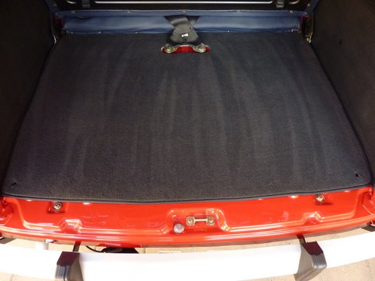

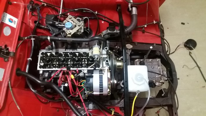

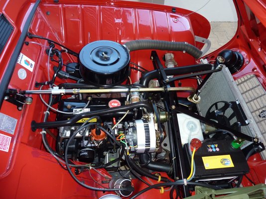

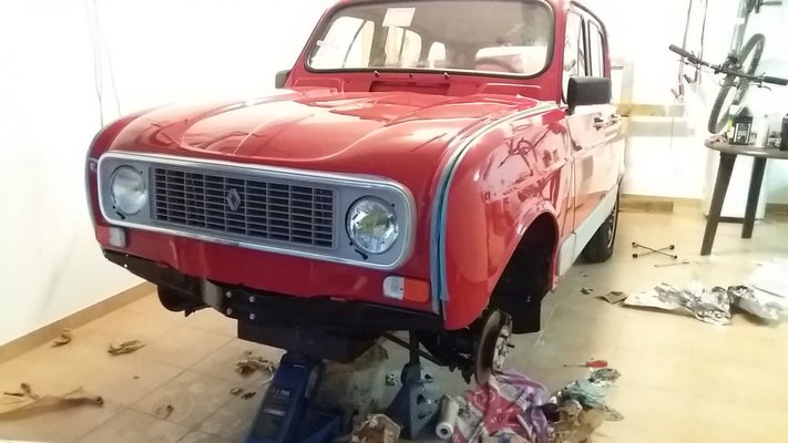

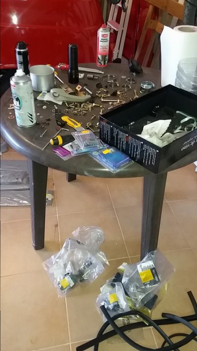

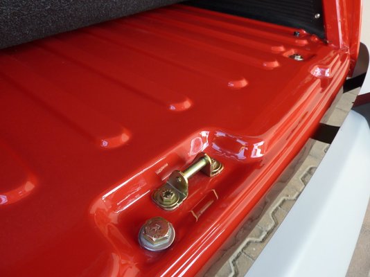

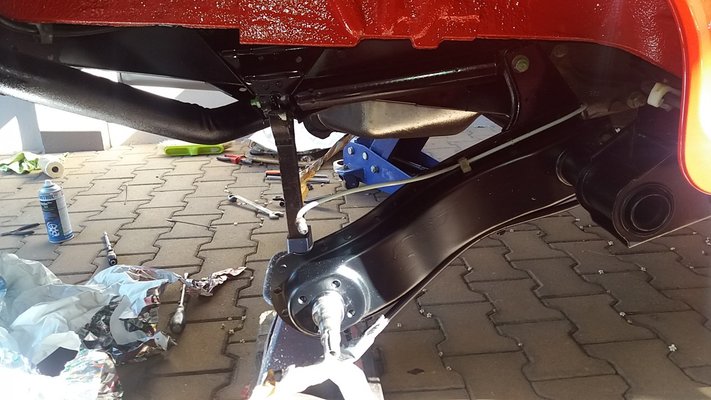

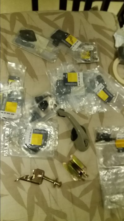

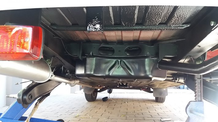

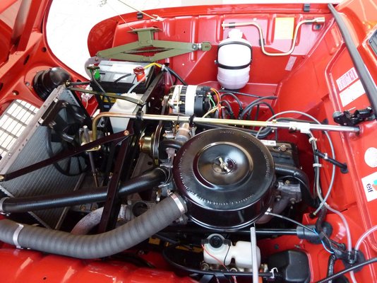

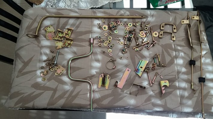

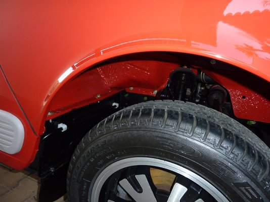

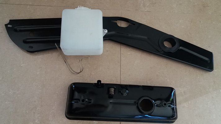

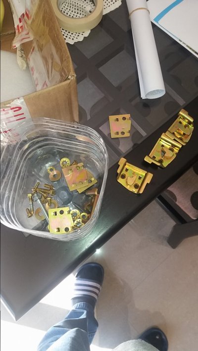

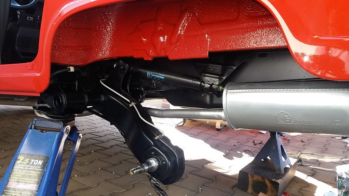

The fianl assembly was fairly quick as I had already spent a lot of time preparing and sourcing all the parts necessary.

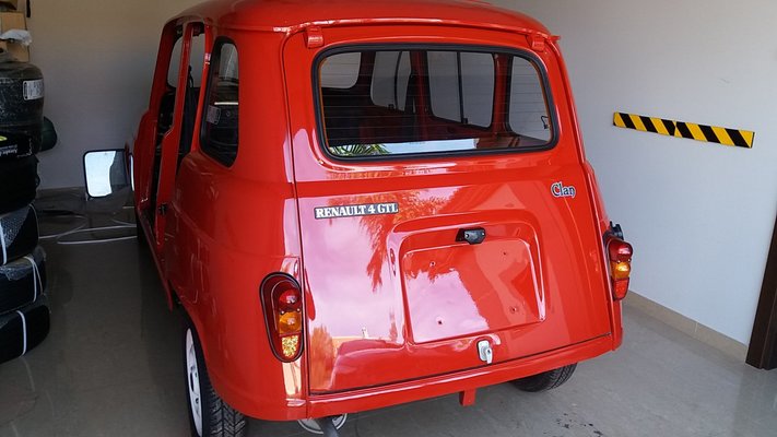

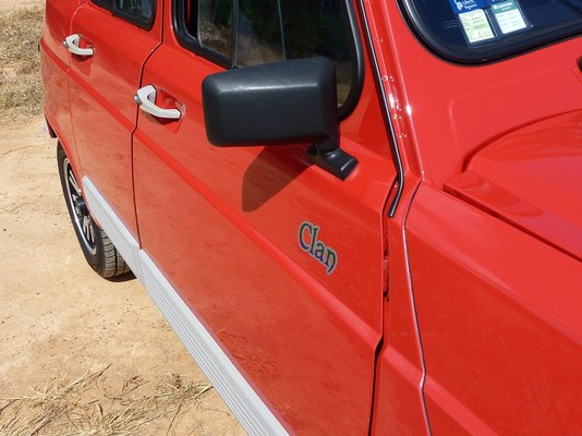

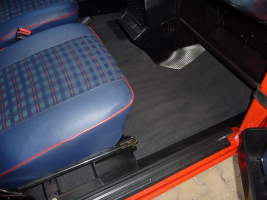

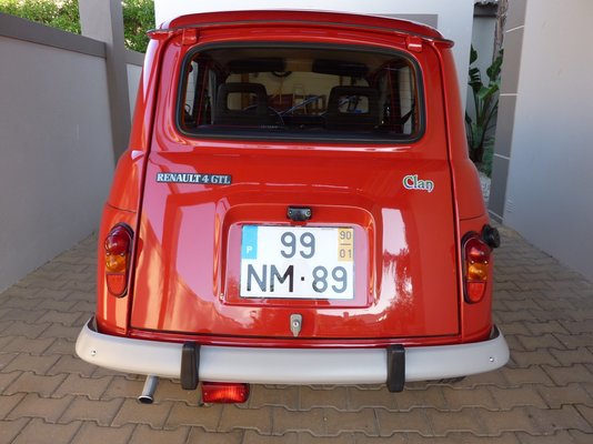

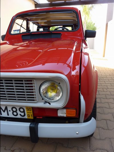

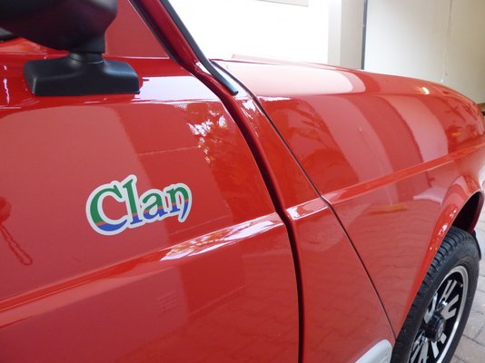

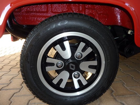

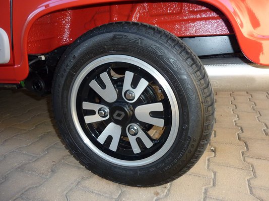

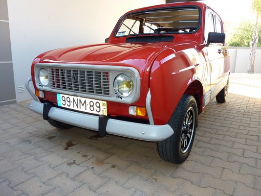

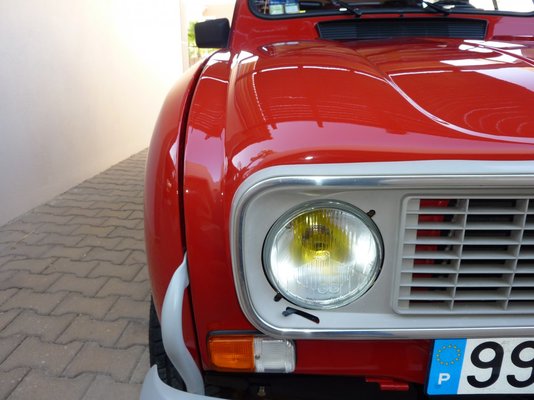

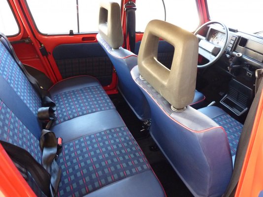

Thank you JdeW. It was a relatively simple restoration because the car was in such good condition to start with...

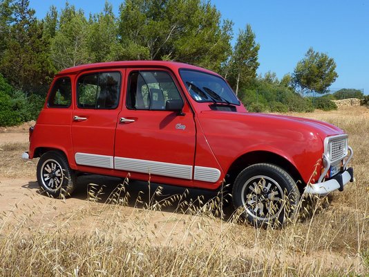

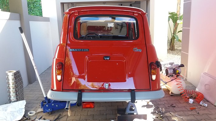

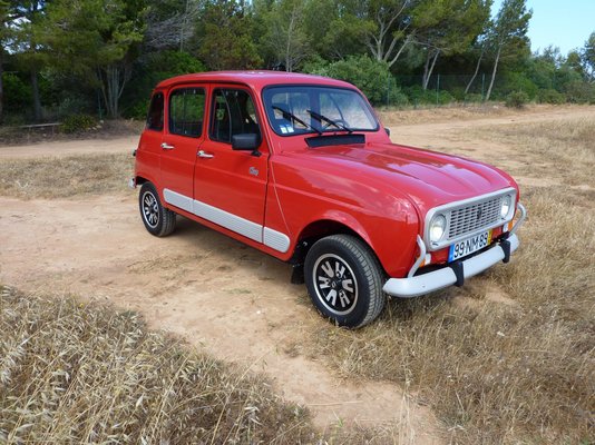

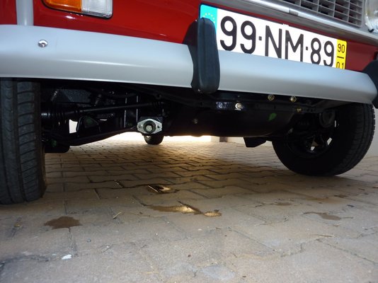

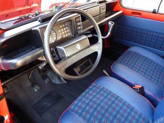

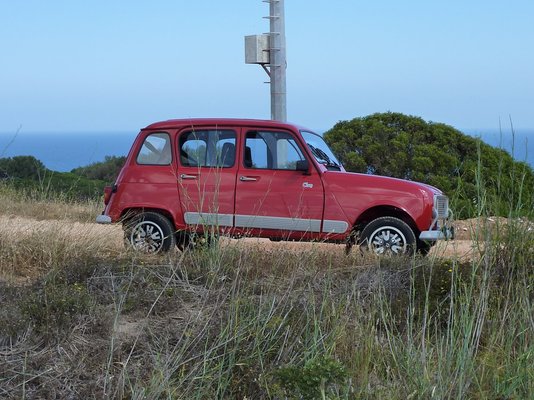

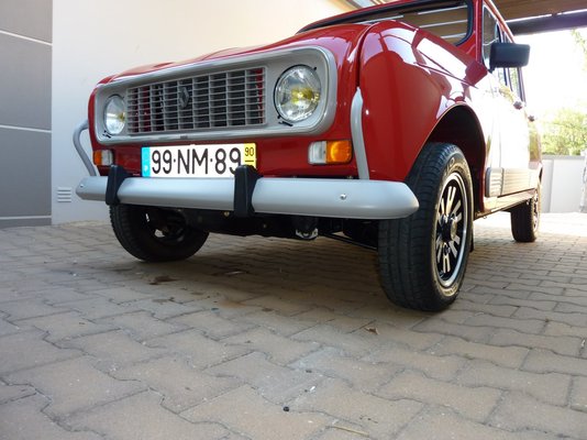

The final product...

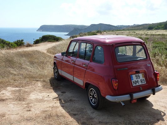

..some more pic...
