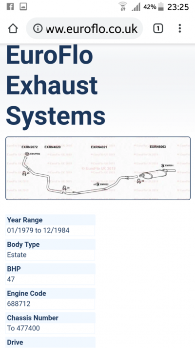

Good afternoon all,
Would one of you kindly give me the part number for the central exhaust pipe section for my 1108cc GTL ?
The VIN no. is 112800F0000481.
Engine number C048485.
Also the best place to order it from please.
Many thanks
Charles

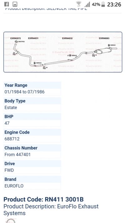

don't forget that officially the later cars had the exhaust system running further inboard than original gtl this made car easier to lift on 2 post ramp
renault superceded old parts to later setup and discontinued old design
aftermarket gets very muddled with some using old pattern and some later
either setup works but parts don't mix and match
Mr auto have got stock if you pretend you are in France to order but won't ship long bits overseas exhaust for any cars

Well my mechanic has just called to say the exhaust doesn't fit (ffs) as suggested might happen by the helpful members above !
So he has repaired existing one which he says is a genuine Renault one.
If anyone would like my Bosal one, as above, for cost price (£25) then please get in touch.
I am a mile from J5 M3.
mr-reno-139
AKA Paul Cunningham
1,850
lancing west sussex england
#13
it will fit if you look at my pics above you have to fit the matching section before it too and then remount further in or out depending on what gets supplied
