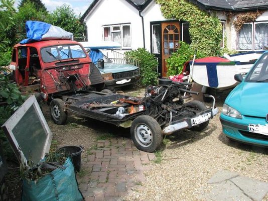

Also me and dad are disagreeing over how to take the tub off - Some one told him to cut thou the door post so to leave the bulkhead inplace where i want to remove it all cause my inner wings have had it and need repair or replacing but i think i'll leave it all together and do what welding that i can till i'm happy or need to remove the tub to look at the chassic..
Also could need a place to store the tub or chassic....not much room at home....
Take it off in one piece, don't start cutting and shutting is my advice.
If you remove the bolt on wings, doors, bonnet and tailgate, the whole thing is fairly lightweight. Undo the bolts that hold it down to the chassis (see Haynes Manual), disconnect wiring, heater pipes, gear linkage, handbrake, steering column, seat belts and I suggest, unbolt the inner wings as well, and with a little gentle persuasion and some wedges under the bolt down points, you should be able to release it from the mastic bed and lift it off.
If you take out the seats, you can lift it up a foot or so and just pull the chassis out forwards on its wheels.
Have a look elsewhere in the Projects section and Clementines website and you will see a few examples of how its done.
I left the engine in place whilst I did mine. If it is stored outside, just wrap it up in polythene to keep the weather out.
I agree - Its quite easy to take the whole top off, just about 20 bolts around the edge.
Remove seats
Disconnect controls
Remove outer and inner wings
Disconnect handbrake
Disconnect wires from engine
Disconnect fuel filler (jubilee clips, remove rubber section of hose)
remove bolts around edge of body
And Lift ! :) (With a bit of rocking if the glue is stuck)
(I took the top off mine in a day)
Then I took the engine out as was quite easy and rolled the chassis on its side for welding :)
Also for storing the body/tub I just lifted it up and rolled the chassis out to weld and back underneath when not working on it so it took the same space as the car :)
You guys have so much room :(
