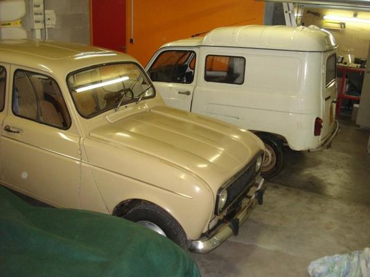

Good evening everybody ;)
for a week amany things have changed, I also discovered some good surprises, but unfortunatly also bad ones... I went to pick up the car with my friend Sylvain, he managed to make the engine start, the carburattor and the fuel pump was so dirty, this is the reason why the car didn't want to work well. Afterthis day my lovely new car was at home with my others cars :D :D

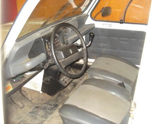

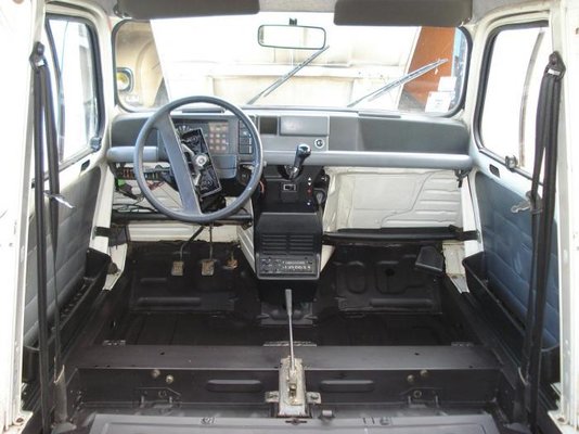

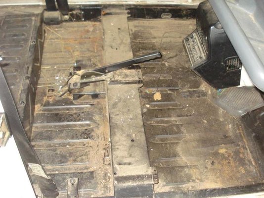

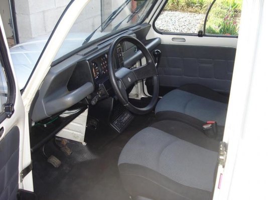

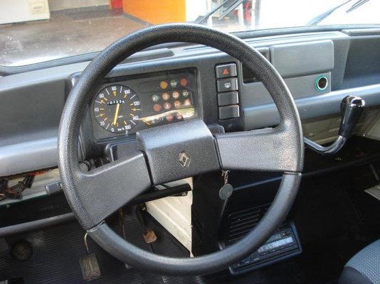

As I already did when I bought my last GTL I started to verify all the critic points on the body and chassis; concerning the chassis it is in very good condition except one of the "brancard" (hum, what is english for this word :confused:) which is rusty. The floor is also almost like a new one:

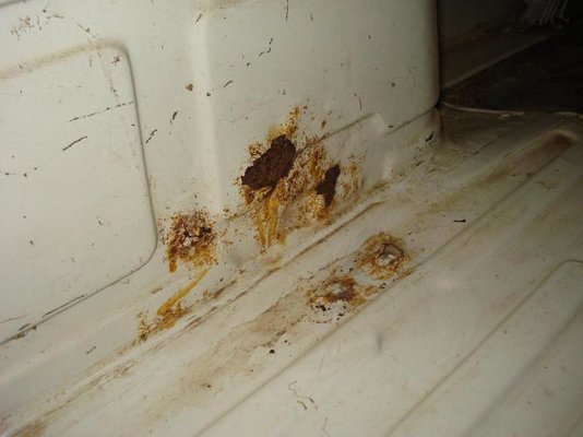

The body has got several "bumps" but no rust except this classic one, only at the left side:

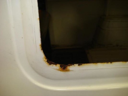

And few rust under the side glass-seal:

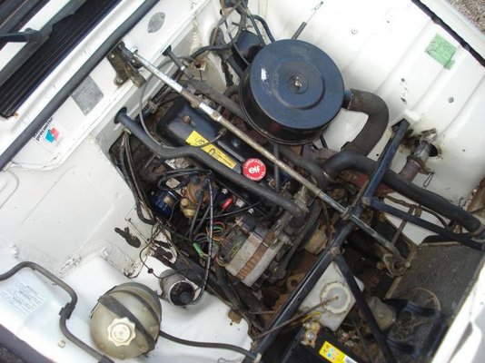

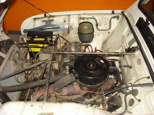

The engine is a C1E, 1108 cm3, with 107000 km:

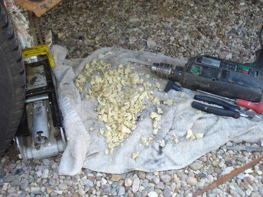

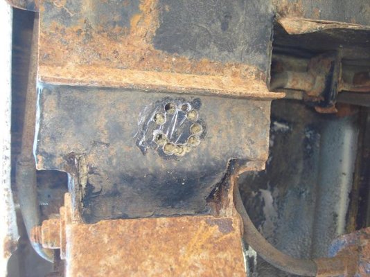

Yesterday I went to the car wash to clean all the mud under the car, when I went back home I made a special thing, to avoid rust at the extremity of the right rail: I drilled a 20 mm hole and with a screwdriver I removed all this s--t in the rail :cool: :cool:

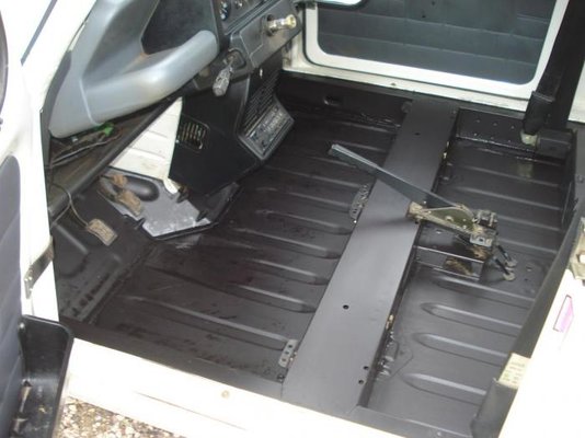

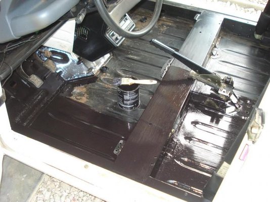

Protecting the floor against rust:

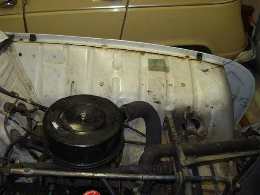

Cleaning of the left inner wing:

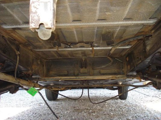

I continued to work on my F4 to make it a beautiful car, on thursday I changed the fuel tank which was drilled by rust (I've never seen that before :confused:), at the left of the picture, just above the exhaust tube, you can see the only problem on the chassis:

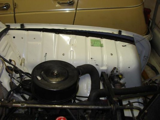

I finished to clean the engine bay, it looks like a new one :D :D

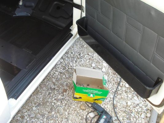

I also fitted these "things" (vide-poche, seuil de porte ???) taken on an old GTL, the passenger compartment is now ready to receive the news seats:

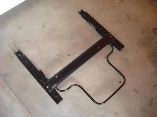

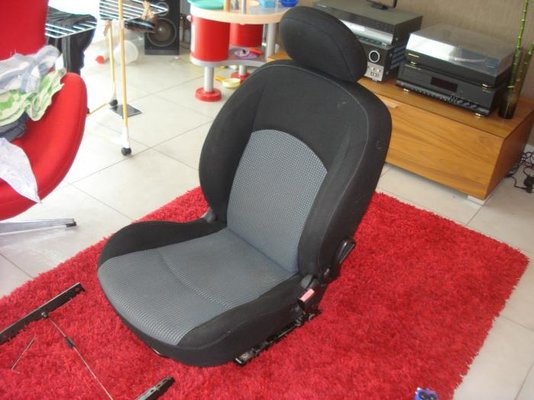

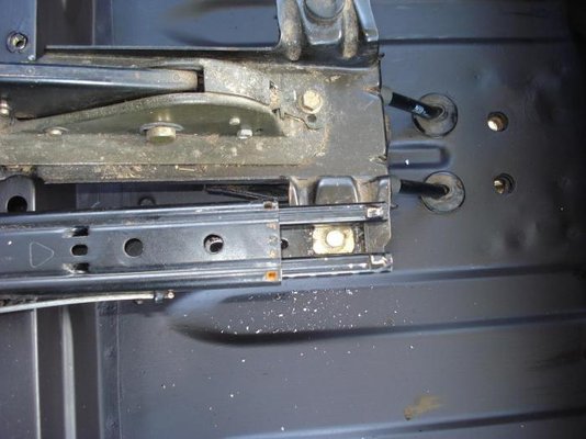

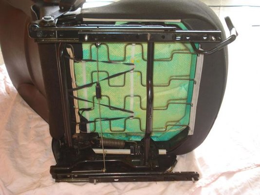

Yesterday I went to my favorite scrapyard to buy 2 good seats for the F4, when I arrived I really didn't know what seats to choose, I walked across the wrecks and looked inside during more of one hour... I had to find nice seats but also mountings simple to adapt in the R4. Contrary to most people who fit R5 or Twingo seats, I decided to buy these seats taken on a Peugeot 206 XS:

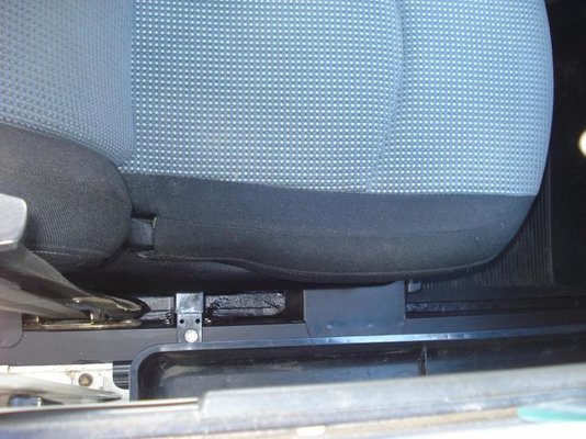

The center distance of the 206 slides is 465 mm, that of the R4 moutings on the chassis are 479 mm:
I simply fitted the 206 slides on the R4 chassis in the existing holes along the rail, I just drilled 2 new holes in the center moutings of the R4 to have the good center distance, I took 3 of the 8 mm torx-head bolts of 206, but I had to take a 6 mm diameter bolt at the rear of the slide to keep sufficient steel in the R4 mouting:
Very simple isn't it ? BUT I'm going to have a problem... :mad: :mad:

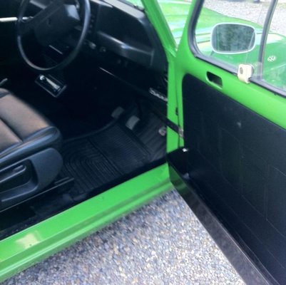

Lovely F4. It is great you got one without reverse lights.
Door pockets are great! I had them installed in my van too as they are very practical

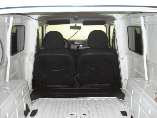

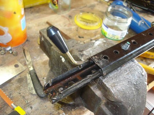

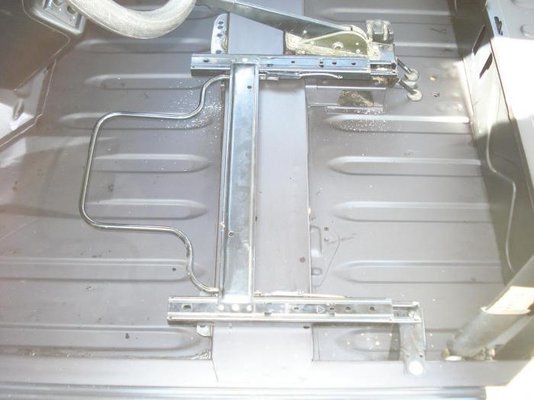

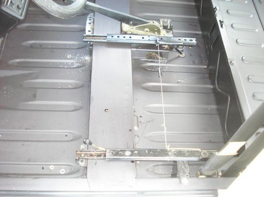

Now, end of the story of my new seats... After fitting the 206 slides on the chassis, I screwed the 206 seats on the slides... BIG problem: even with the seat back adjusted at most, I was still too close to the dashboard, with knees in the sterring wheel, and head in the windscreen :eek: :eek:
This is the reason why I decided to use R4 slides, I just adjusted the bar between the slides:
The only modification ? I had to shorten the adjusting lever of 4 cm to leave enough space with the seat:
The Peugeot 206 was fitted on the R4 slides, I just had to ovalize a hole of the slide with a round file:

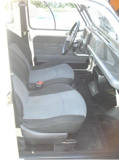

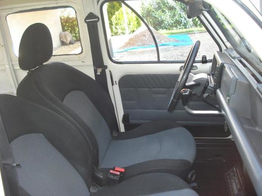

And now... look at this beautiful result :hug: :hug: :hug:
The space with the door pocket is not a problem as you can notive below:

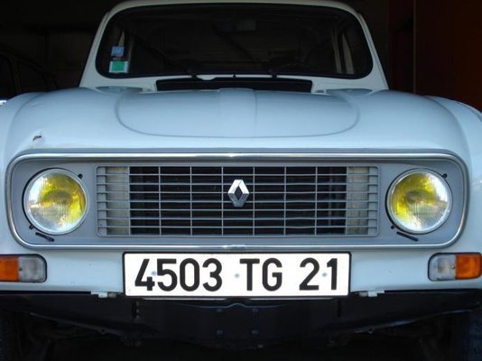

My steering wheel was too damaged, I found a Supercinq steering wheel with the new Renault Badge...
... new badge, that we also have on the front grille :D

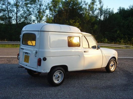

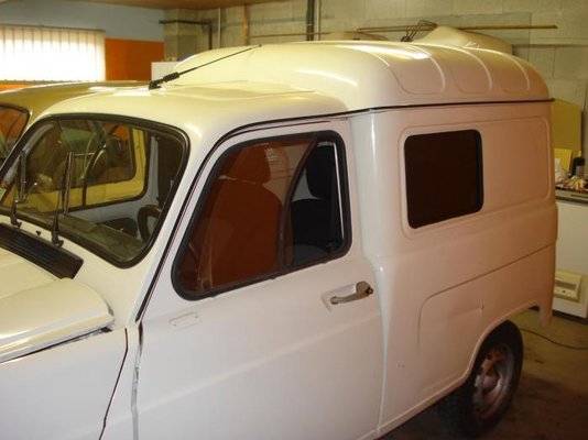

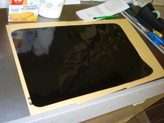

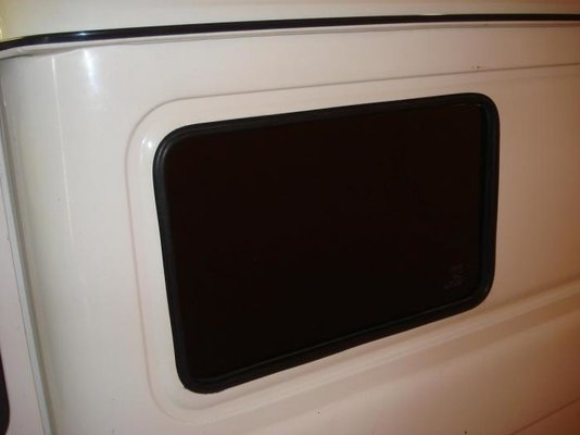

This afternoon I made something I really hate because according to me it's really difficult to do it whithout defects... I remind you at the beginning I wanted a F4 without side windows behind the doors, but... as french people usually say "we do what we can, and not what we want... regrettably" :( :( So I find this car in very good condition not far from home, BUT there were these little rectangular glasses...
Today I learnt on the french forum that these glasses were fitted by the french Renault dealers when the buyers wanted them, they cut the side panels to fit these glasses... with no rust protection after cutting :mad: this is the reason why many cars are rotten behind the seals... as mine :mad: :mad:
So I decided to make something: fitting something called "film teinté" in french on the glasses to prevent seeing through the windows. I carefully cut this "film" at the exact dimension of the glasses and fitted it...

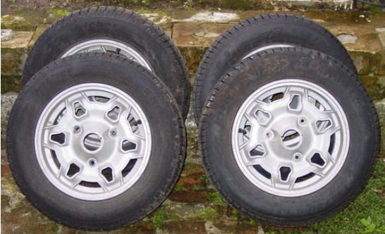

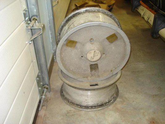

Today I also receive a parcel with something inside for my little and lovely F4:

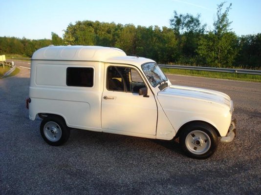

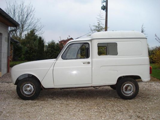

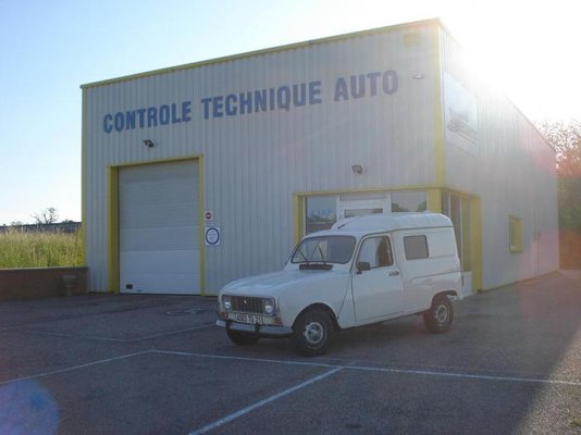

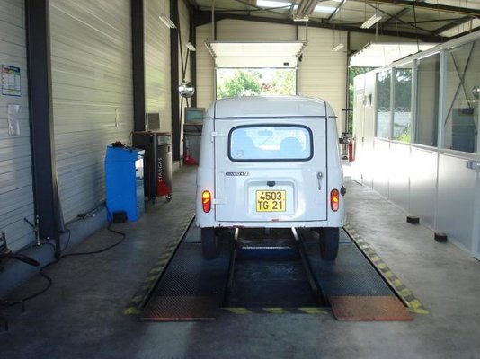

:cool: Hi everybody, few news of my F4 which passed the french CT 2 weeks ago, just to repairs have to be done: adjustment of the left front light, and rear bumper to fit because I dismanted it when I went to the CT...

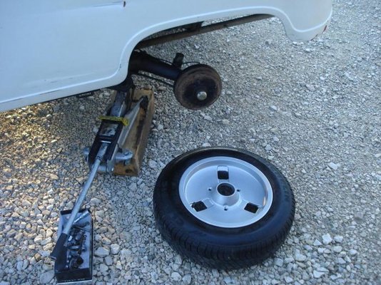

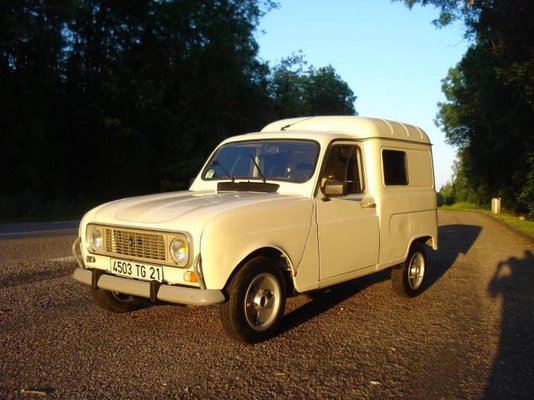

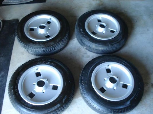

Also several pictures of my F4 with its new Alpine rims, the result is exactly what I was looking for when I bought it, the only urgent thing to do is finding a rear bumper, mine is really so damaged and cannot be repaired.
I also have to make littles paint-repairs where I applied my red antirust primer, and the car will be finished...
