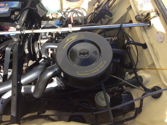

Heres a photo of my airbox, yes its held down by wing-not, but the wing- nut thread has not got enough grip after years of on-off to hold airbox firmly, hence nut on top of it to ‘lock’ it., standard metric 10mm bolt thread so if you’ve got a handy hardware store local you may find a replacement, if your air box is the same as pictured they do not have the hose fitted to the intake.

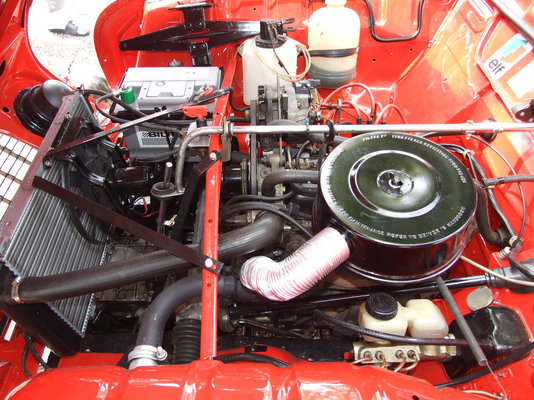

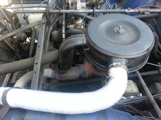

The hose seems to be going somewhere, with determination. Where it is going and why, I have no idea.
laxeian
186
Galicia
#5
There to direct warm air off of the exhaust manifold into the airbox for cars marketed for sale in colder climates to aid cold start ups.
