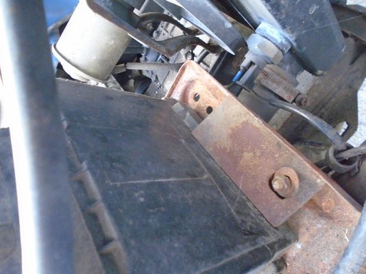

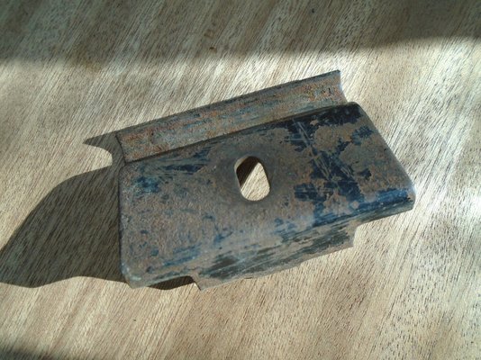

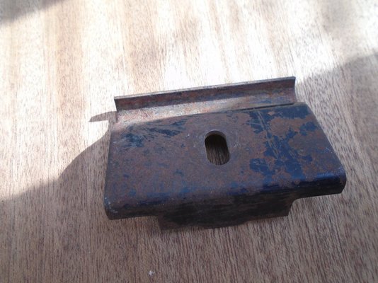

Most GTLs I've seen came with a device like this:DSC00563.JPG DSC00565.JPG
It fits against the long side of the battery. If your car has been fitted with a larger battery, it's easy enough to make up something like this:DSC00562.JPG

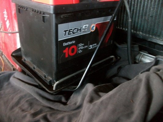

Thanks for these ideas. I have a very large battery fitted which fills the whole tray. It is in good condition so I thought I would keep it. I have bought a battery retaining strap and cut down the threaded rod and made new hooks on the end. It looks good now. Much better than bungies
