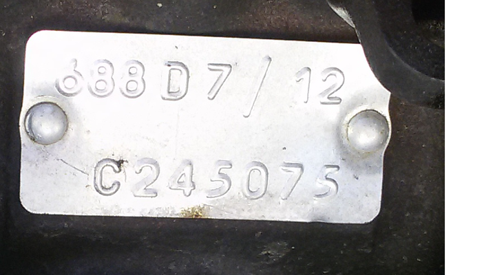

Hello My zenith 28 if is giving me problems, so I believe it's time to replace it for something better, but like always my first step is to come here asking your advises.
So I am thinking of getting a zenith 32 if7 but I don't know if this is the best option for me My car is an 1991 gtl with 688 D7/12 engine
Hello Fernando, a bigger carb (32mm instead of 28mm) also needs another manifold with the 32mm carb fitting.
I've the same engine (688D7/12) and Zenith 28IF in my GTL and never had any problems.
Most common issues are that somewhere false air is sucked in, a wrong positive valve setting or that the carb bottom is crooked by overthightening the nuts.
There is a lot to find about carb issues on this forum, just use the search option.
Regards, Joop
