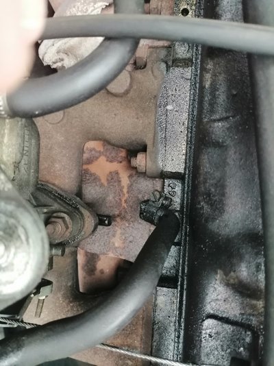

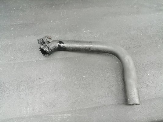

IMG_20210111_133113.jpgI think I found the problem, can I use a universal size tubing or is this a special part

Hi Minty
That looks like the hose with the restrictor valve in it, which would tie in with the symptoms you outlined. If you feel along a bit from the hose clipped end of the hose, there should be a one way valve inside the hose. If the hose is only split at that end, you could cut it flush and you might have enough purchase to refit it with a new hose clip. If this is not feasible, I would source another hose.
Best Wishes
I trimmed it back as far as I could and fitted a new clip. It seems to be holding OK for the minute but it's fairly perished looking (a bit like myself). I'll go on the hunt for a new one.
Thanks again
I would advise fixing this first, THEN seeing if the car behaves better. If you adjust something else simultaneously you'll not know where you are and may become confused. Report back once the pipe's repaired first.
normal 8mm fuel hose works fine as long as you are careful pushing it onto the plastic T piece as they go brittle make sure you remove the Old plastic restriction please and fit it in the new rubber tubing otherwise you'll be back to square one with the same running issues
I have a breather kit ordered from France. When it's fitted I'll try and adjust the carb
