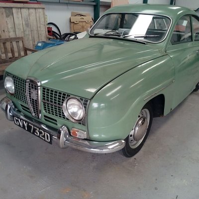

My '66 SAAB 96 two-stroke also has a freewheel which can be selected, also enabling clutchless gear changing. Most two-stroke cars had this device due to the engine lubrication for the pistons (roller bearing crankshaft) being entirely from the oil/petrol fuel mix. As such, with very long downhill situations using engine braking, there was a risk of the pistons seizing, but with the freewheel engaged the engine would just be idling. It worked well for Erik Carlssohn with his RAC and Monte Carlo rally successes, but his nickname was 'on the roof' as he would frequently roll the car! Not for the faint-hearted.....SAAB 96 Two-Stroke 1966 301.jpg :

My '66 SAAB 96 two-stroke also has a freewheel which can be selected, also enabling clutchless gear changing. Most two-stroke cars had this device due to the engine lubrication for the pistons (roller bearing crankshaft) being entirely from the oil/petrol fuel mix. As such, with very long downhill situations using engine braking, there was a risk of the pistons seizing, but with the freewheel engaged the engine would just be idling. It worked well for Erik Carlssohn with his RAC and Monte Carlo rally successes, but his nickname was 'on the roof' as he would frequently roll the car! Not for the faint-hearted.....View attachment 26825 :
That's a fantastic looking car!
