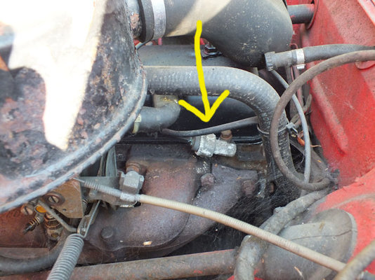

This thing is the temperature sensor -

Hi I have had a look and can't see one of those on either side of the engine. There is a threaded (?) hole in the block at that position which may be the location of the mounting, or where a temp probe is inserted. I can see one random wire coming out of the loom, which has been fixed to the cross member between the inner wings. So at the moment confused. Regards Edwin
Later cars often had a sensible temperature sensor in the water pump. That could be what the wire is for.
Thanks for all that. The Spanish has the wire but the sensor on the block is missing, and there is no sensor in the water pump housing . My French R4TL has the water pump sensor location. Thanks Edwin
