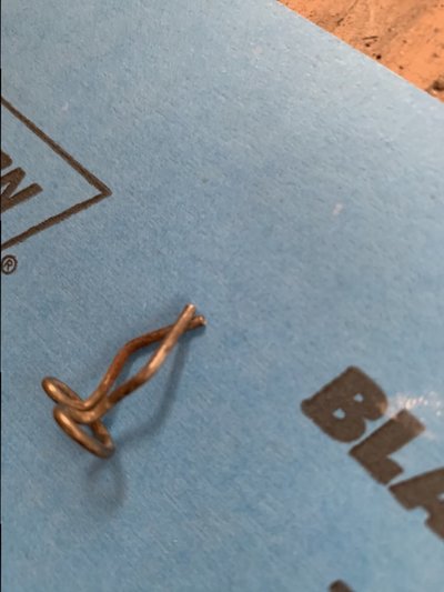

Hi there does anyone know where to get the metal retaining clips for the door cards? Or a different solution?
Piezas in Spain do stock these clips, they come in packets of 50 though for iirc @€25 , so my alternative method was a few pairs of pliers reforming the distorted old clips to resemble the nearest to new shaped one, patience and a few choice moments of cursing.

Although there is a hole for such a clip in the card directly below the door handle -DONT put one there! It will interfere with the operation of the door opening lever pad and keep popping out which is an irritation and can spoil your nice new door card coverings

Have found 20 door clips. Can you pm or email me your details?
