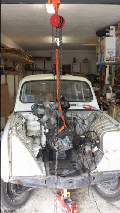

It is a couple of years since I bought this nice 1975 export... and now I decided it was time to begin her complete restoration, doing what I never did before, beginning with the engine removal

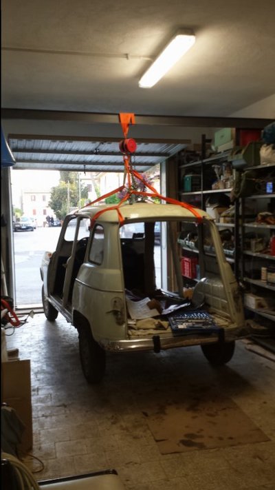

and following chassis/body separation

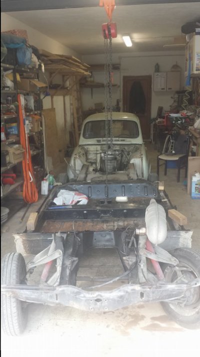

Now I will dismantle the rest of the stuff on the chassis in order of making some welding and paint it, while the body will go to the body shop.
Very worried about taking away rear and front axles... i fear not to be able to put them on again!
But even with all those preoccupations I am very proud of my work!
I'm sure Andrea that you will get lots of encouragement and good advice on your "journey", so not to worry. As one who has restored one or two cars in the past, it's not as daunting as you think, and as long as you work methodically and with care you will get there.
I am happy to hear you are going that road.
It all depends on how detail you are planing to go.
But it is much easier than it looks. R4 is simple car.
For me worst part of whole process is cleaning old paint and rust and preparing parts for galvanizing or painting.
But then again i went little bit to far in some details.
My advice ( if i may;)) take detail notes when dismantling and tons of pictures.....they are saving my ass sometimes
Good luck and post pictures of your progress
When I restored mine, I took off all the parts of the car EXCEPT the rear and front axles, I work on R4s for almost 25 years and I never touched these particular parts, I'm sure I woudn't never be able to adjust them correctly after fitting them on the chassis :ashamed: :ashamed:
