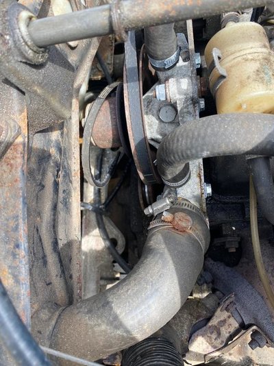

I am no mechanic but had checked the quality and levels of all fluids as well as (I thought) checking the tensions of the 2 belts.
Apologies for lack of correct terminology but the lower of the 2 has a habit of making a screeching sound.
Anyway, I set off and drove nearly 200 miles without incident apart from intermittent squealing. I stopped to refuel and as there was an AA van at the Services and I have been a member since 1986, I asked for him to take a look. He thought that the lower belt should be a bit tighter so he tightened it.
On I drove and about 10 miles further on there was a noise from the engine way. This was 2 miles south of Knutsford Services, which is a "Smart" stretch of motorway with no hard shoulder. I carried on to the next emergency lay-by (about a mile) and stopped. The lower of the 2 belts had snapped.

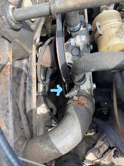

I wonder whether the original screech and broken belt were caused by a sticking or seized belt tensioner - arrowed in your photo (apologies for copying it). I'm not sure if the bright mark on the tensioner pulley is its edge or a mark made by the belt; if the latter, it's likely that the pulley isn't moving as freely as it should. It's certainly worth checking!
Thank you Andy, that is a good point. A previous belt also snapped a couple of years ago so maybe it is the tensioner. This one snapped very shortly after the AA man had tightened it too.
Thanks Adam, will do. I'm in Cumbria so just trying to find someone who knows Renault 4s mechanically as I am pretty useless unfortunately !!
The pump and tensioner should turn smoothly with no grittiness to feel - and no uneven-ness in feel. Tightening up the belt would have made the grip better (hence no squealing) and put lots more strain on the belt if either pump or tensioner were trying to stop it moving all the time!
